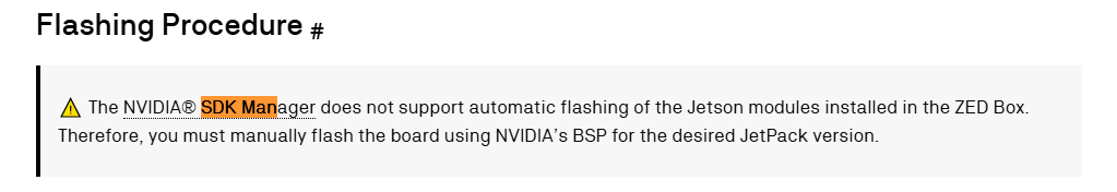

„We have found information about the SDK Manager related to the flashing procedure, as shown in the attached picture, but it did not work.”
Actually, the Warning states that the NVIDIA SDK Manager is not supported.
Have you followed all the steps indicated in the official troubleshooting guide?
