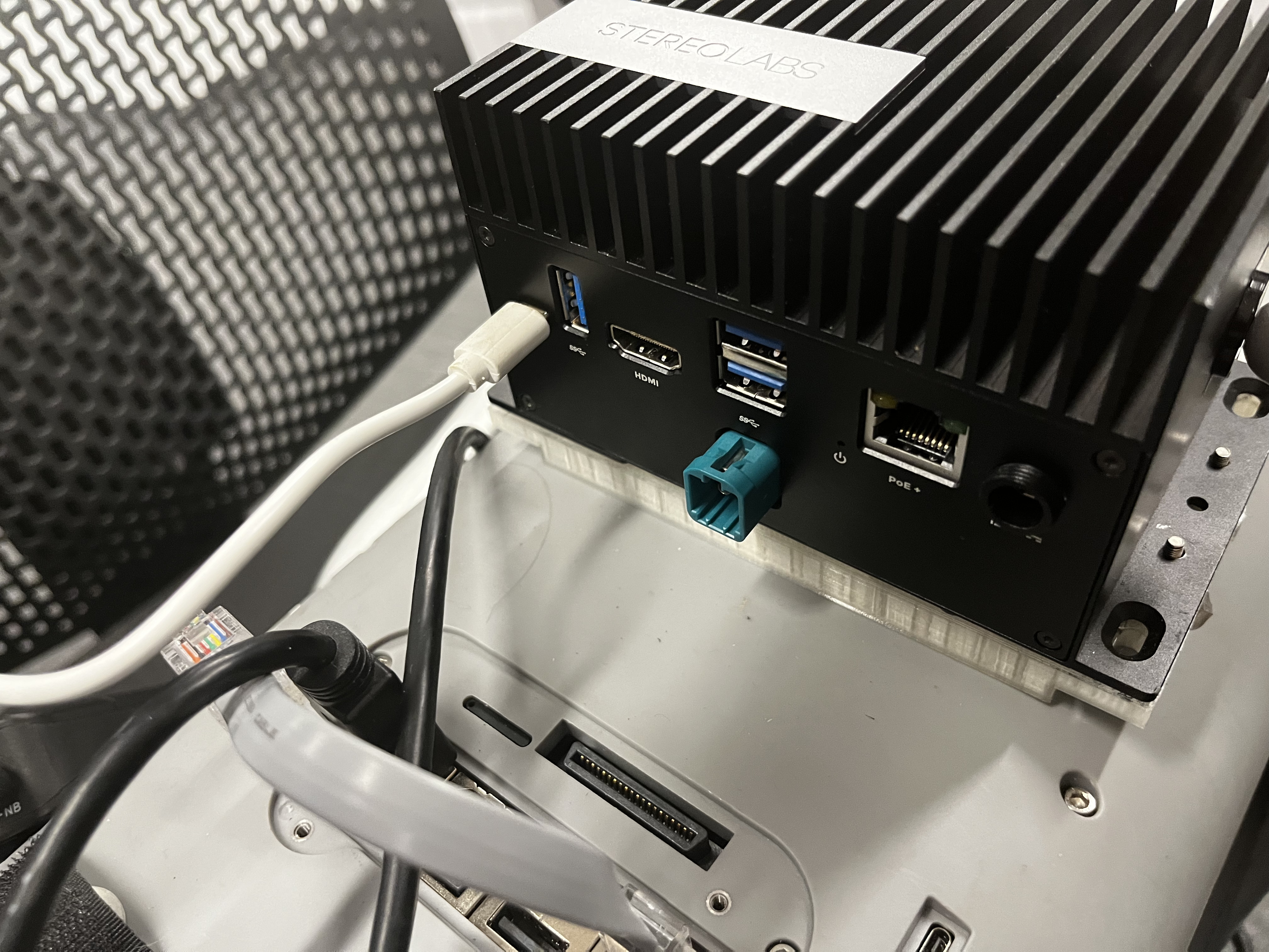

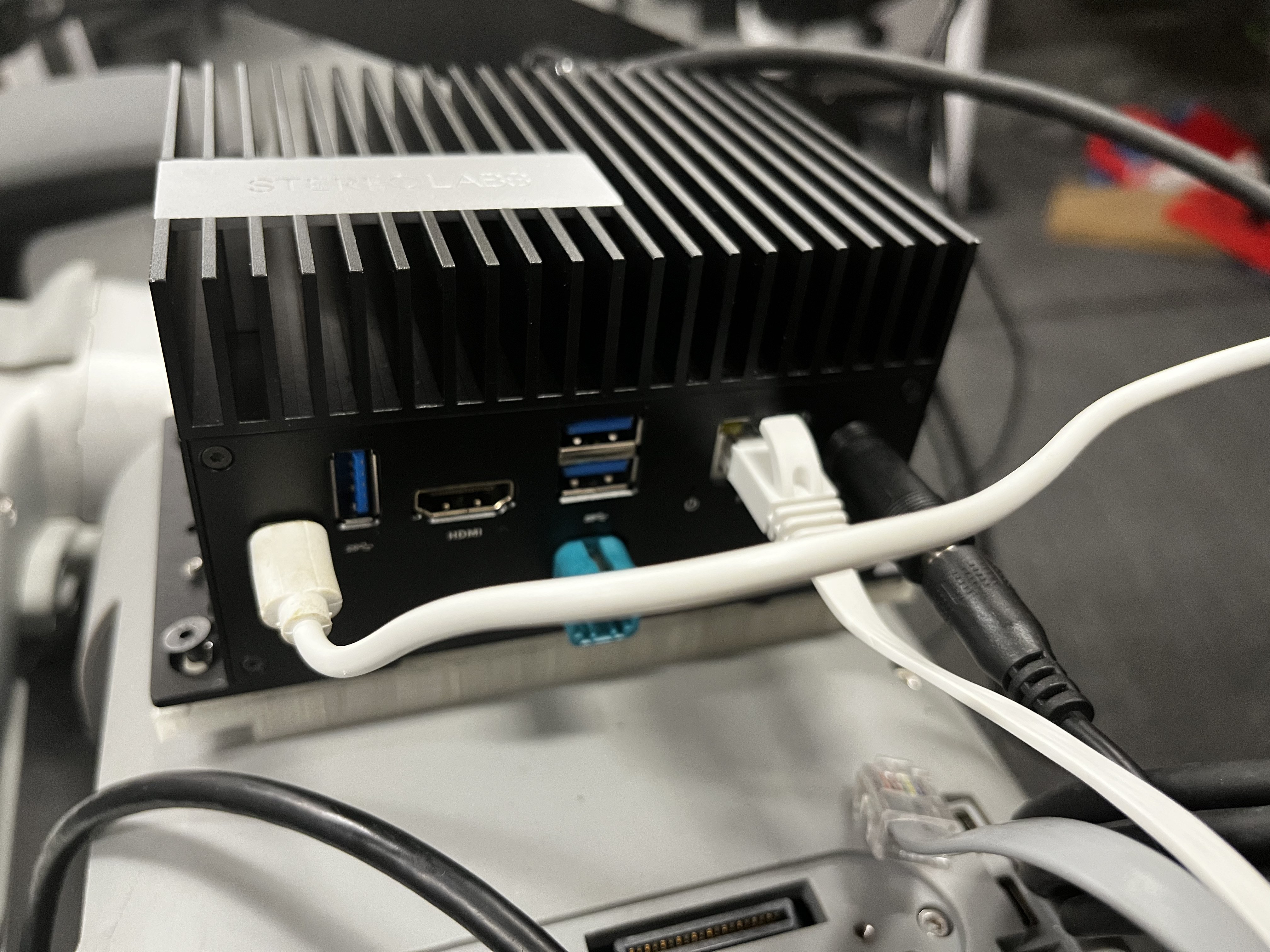

I charge it with DC 12V power supply and plug the USB-A Micro-USB cable. The power light wasn’t on. Should I try to power it using PoE+?
I cannot flash the Zedbox using the OTG port following this guide. Specifically, I went through power cable procedure and device flash guide. The device does not boot into Force Recovery mode in the end. And I cannot power it on. The only thing I am thinking of it to try to use PoE+ cable to power it on. Otherwise, I think we may need a RMA.

Yes, I actually tried to remove both Poe+ and Power Supply, only plugging in the OTG. It cannot detect the Orin.
Yes, for the Troubleshooting - Stereolabs , I remove the PoE+ cable and use only the Power cable.
I guess it is because the hardware failure.
I guess I used 120W DC power suppler to charge it? But actually I don’t if it may become the real reason since I didn’t open the box and test the motherboard
Please connect the Original power cable with this setup (only OTG connected) and then verify that the host detects the Box in Recovery mode.

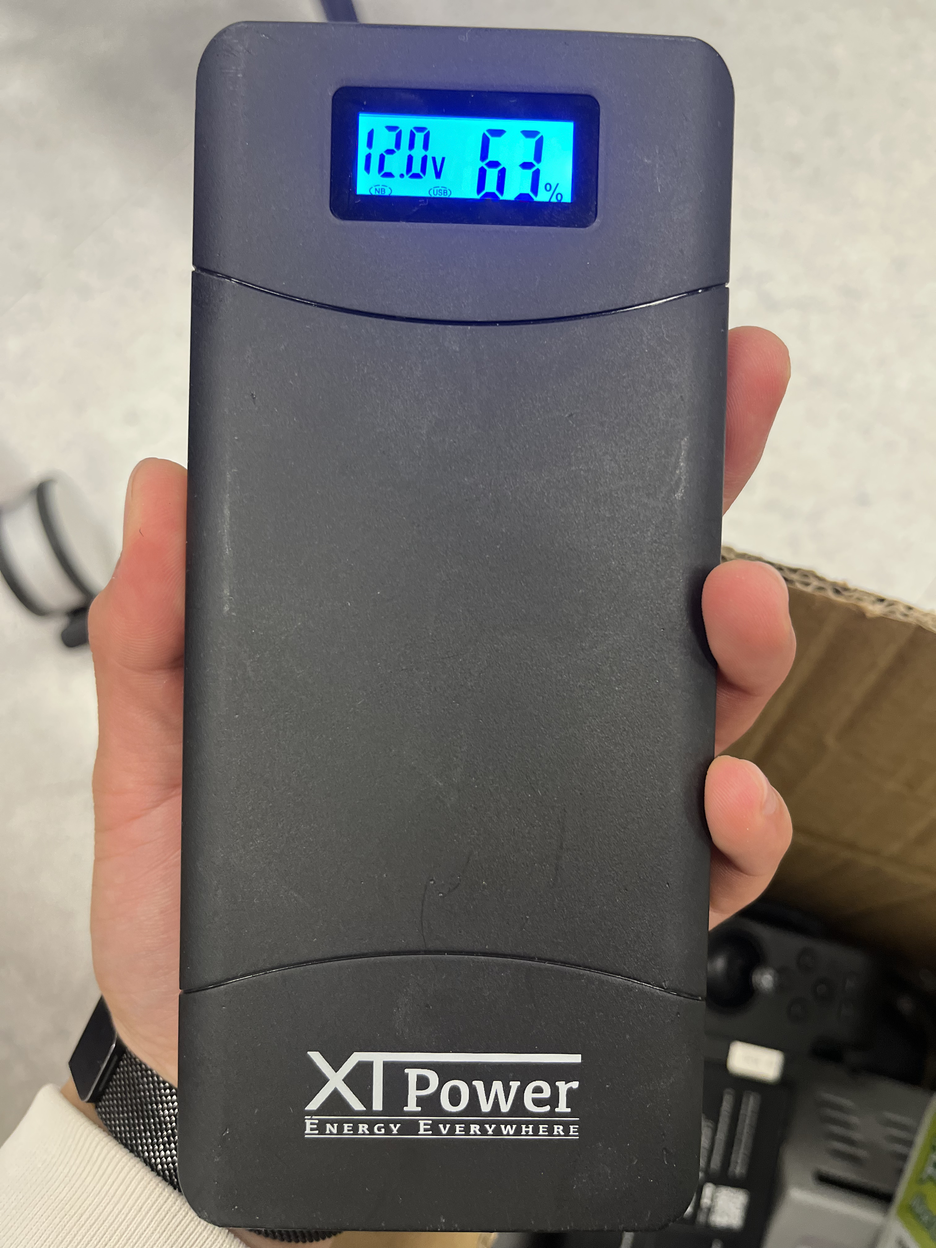

I connect the Original power cable with the 12V batteries. It cannot detects the Box in Recovery mode.
No, I don’t have a original power adaper, I have 12V batteries with low power watt and high watt power adapter (~120W) DC power.
