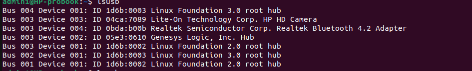

  6. Enter the command lsusb
  7. Check if a device named NVIDIA Corp. APX is listed and send me the associated ID xxxx:yyyy values

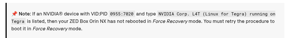

My ID is “Bus 001 Device 125: ID 0955:7020 NVIDIA Corp. L4T (Linux for Tegra) running on Tegra”.

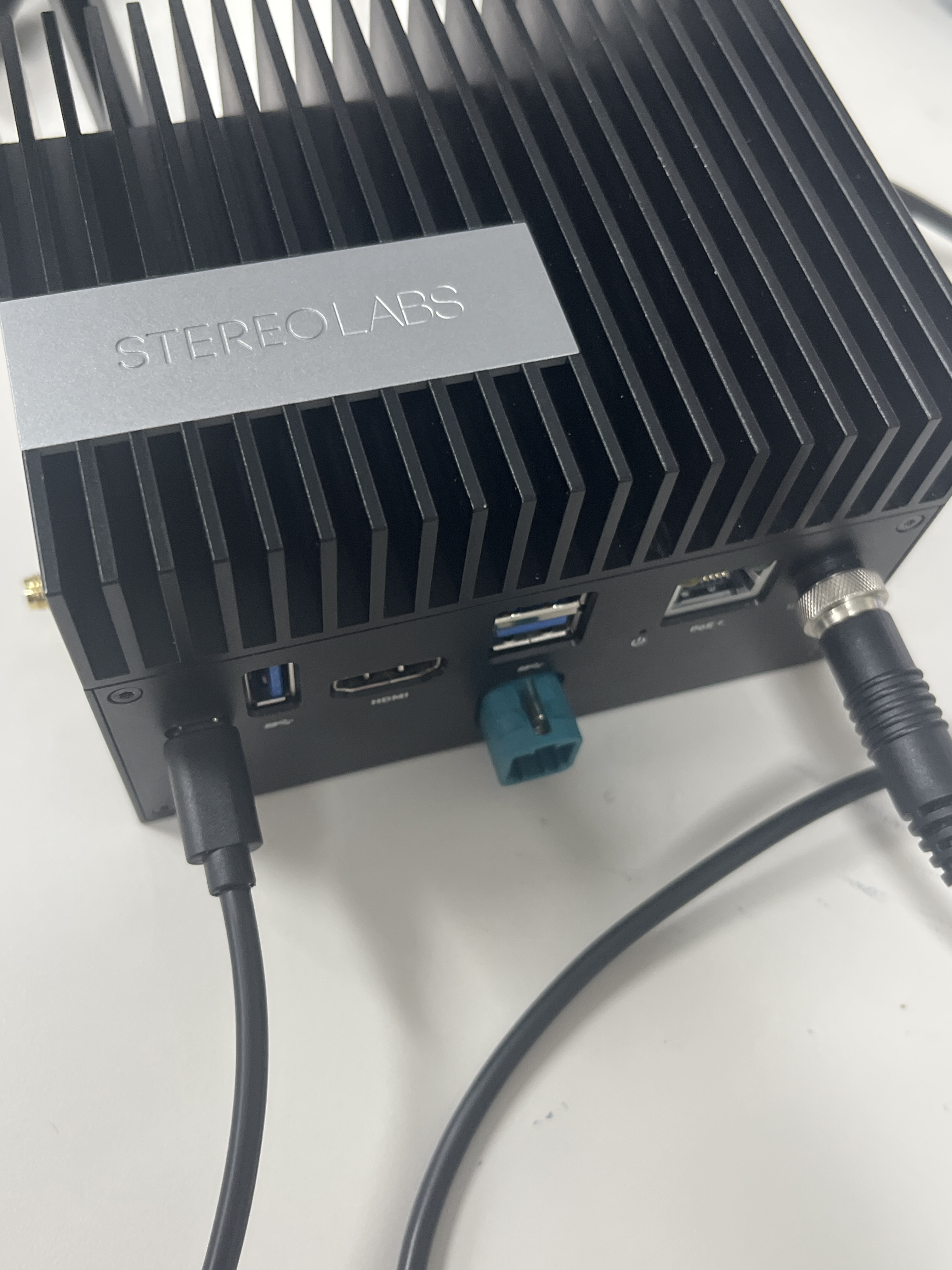

Please send me a picture of your device because this does not match the previous information.
When the ZED Box is in Force Recovery mode, you do not see anything on the screen and the power led is OFF.
You can only interact with it from the host device, as described in the documentation.

Sorry is not Nano based.
I bought a Stereo Perception ZED Box Orin NX 16GB.
“Stereo Perception Kit - USB 3.0” bought.
when connected OTG. it dosent interact.
