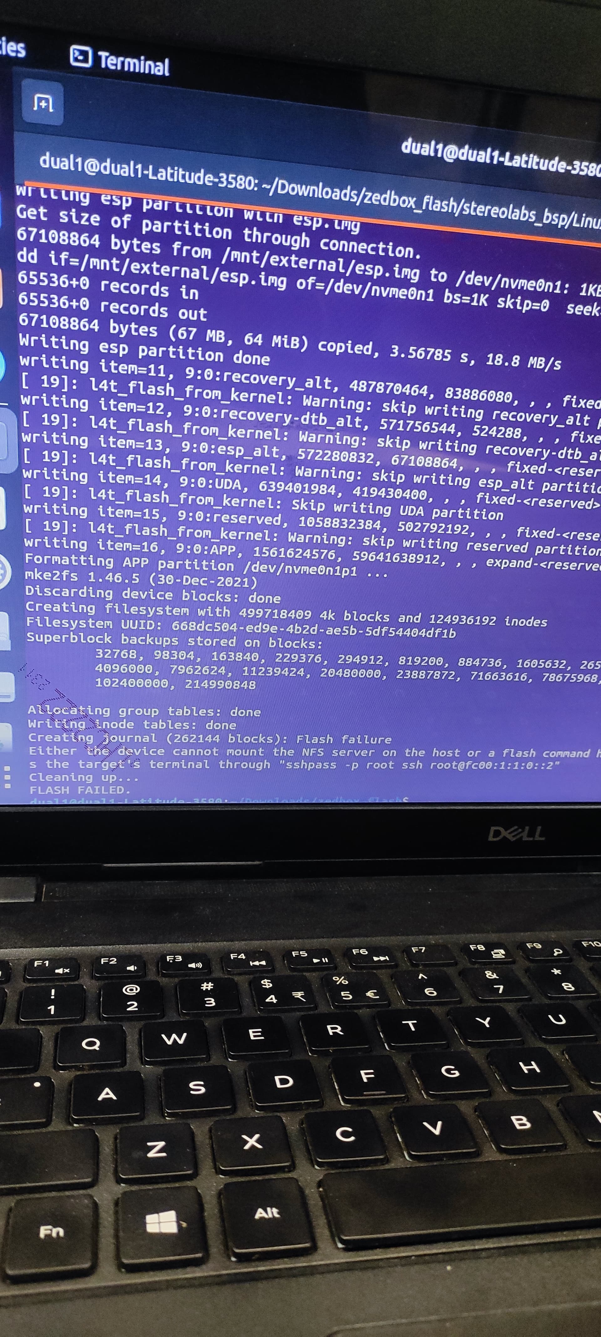

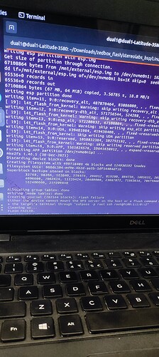

I’m trying to flash my Zed Box by following the provided documentation, but I’m encountering an error during the process.
Here’s what I did:
  1. Booted into recovery mode from USB after performing the USB live flash.
  2. Followed the documented steps.
  3. Encountered an error (please see the attached screenshots for details).
I’m not sure what’s causing this issue. Could you please help me understand what might be going wrong?
Thank you for your support!

Copied 16896 bytes from /mnt/internal/gpt_secondary_3_0.bin to address 0x03ffbe00 in flash
[ 268]: l4t_flash_from_kernel: Successfully flash the qspi
done
Creating filesystem with 499718409 4k blocks and 124936192 inodes
Filesystem UUID: 1557fc32-09c1-4f9f-98fb-9fccbf153669
Superblock backups stored on blocks:
	32768, 98304, 163840, 229376, 294912, 819200, 884736, 1605632, 2654208,
	4096000, 7962624, 11239424, 20480000, 23887872, 71663616, 78675968,
	102400000, 214990848
Allocating group tables: done
Writing inode tables: done
Creating journal (262144 blocks): done
Writing superblocks and filesystem accounting information: mkfs.ext4: Input/output error while writing out and closing file system
Formatting APP parition done
mount: /tmp/ci-C5hidF7tUf: special device /dev/nvme0n1p1 does not exist.
[ 760]: l4t_flash_from_kernel: Failed to mount APP partition /dev/nvme0n1p1
[ 760]: l4t_flash_from_kernel: Failed to write to APP
[ 760]: l4t_flash_from_kernel: The device size indicated in the partition layout xml is smaller than the actual size. This utility will try to fix the GPT.
[ 760]: l4t_flash_from_kernel: Error flashing external device
Flash failure
Either the device cannot mount the NFS server on the host or a flash command has failed. Check your network setting (VPN, firewall,...) to make sure the device can mount NFS server. Debug log saved to /tmp/tmp.VHcSVRkUDp. You can access the target's terminal through "sshpass -p root ssh root@fc00:1:1:0::2"
Cleaning up...
FLASH FAILED.

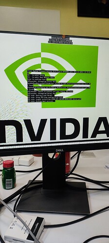

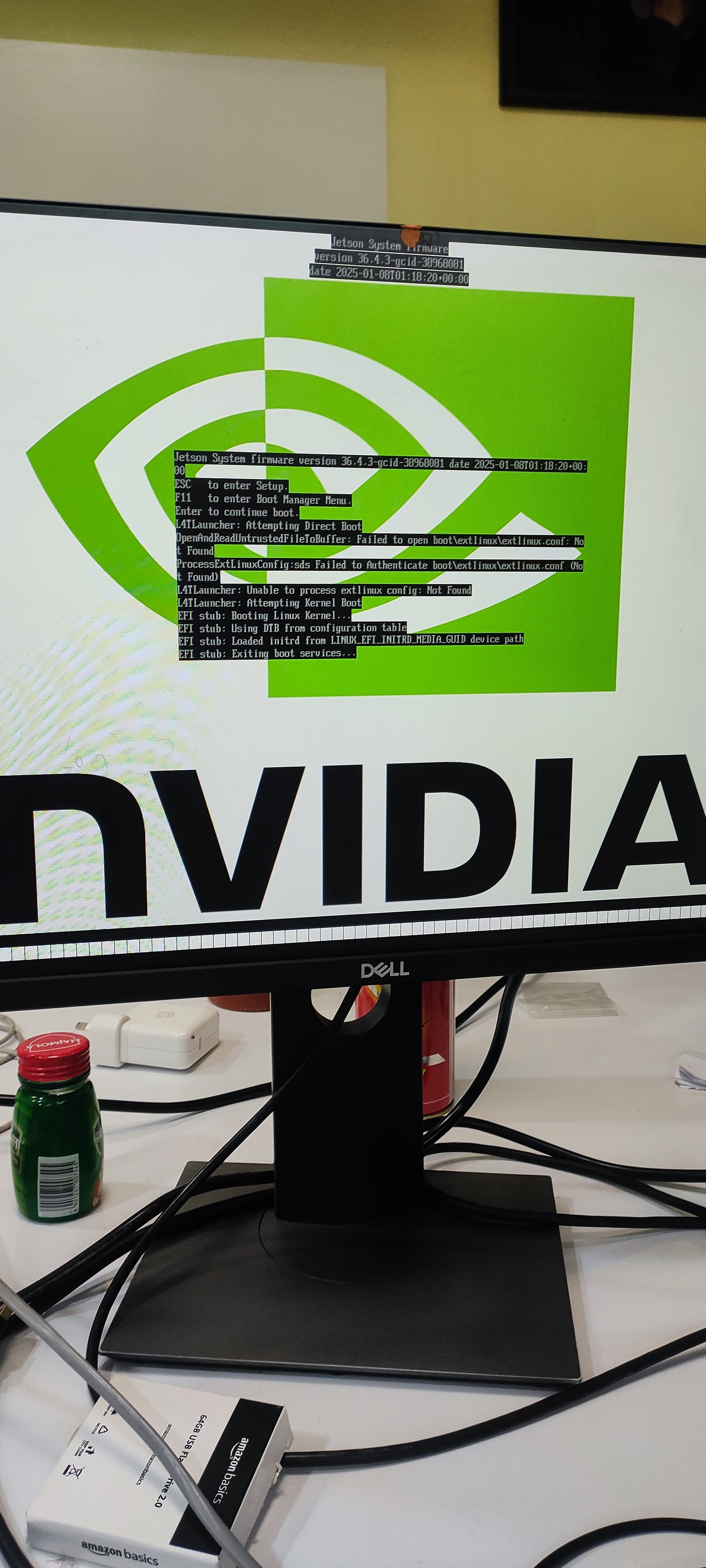

Here something that observed strange, when i followed same procedure again along with same hardware(host device, cable, port) i am getting different error ERROR: might be timeout in USB write..
but when i checked with lsusb its in recovery mode only.
