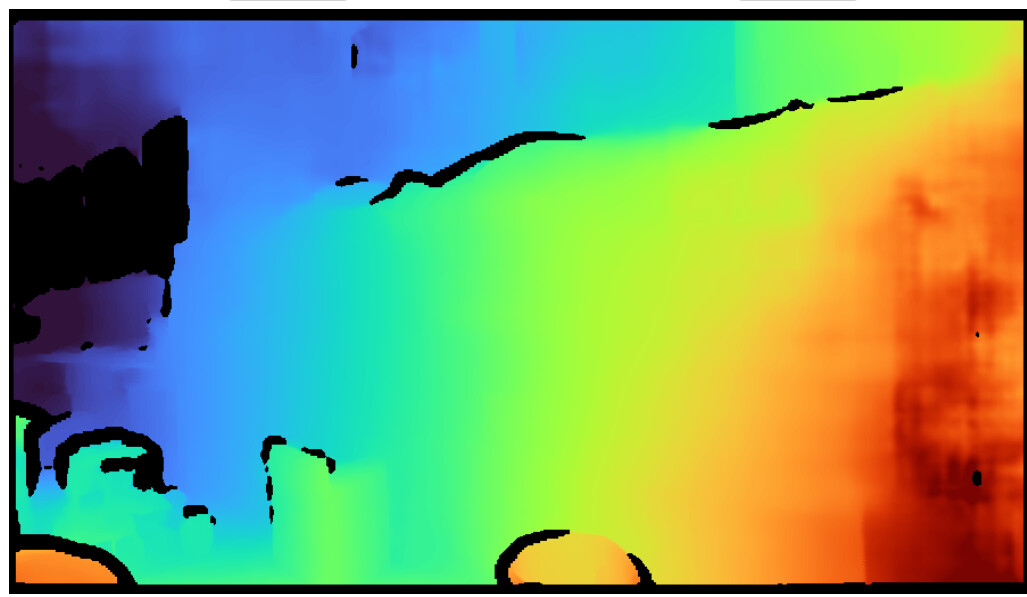

Really sorry about this. I can reproduce your behavior a little:
This two images are taken from 4.0.5 and 4.0.8. The one with more black is 4.0.6 at 0%, the other is 4.0.8 at 1%. I guess the confidence is still too high for you ? If you can send a SVO file, it can really help us understand the issue better. I thought that you actually had less points than before, but in my tests I get more.
What you can try is to remove the NEURAL model from /usr/local/zed/resources, to force a reoptimizations. You’ll be sure you have a fresh installation.
