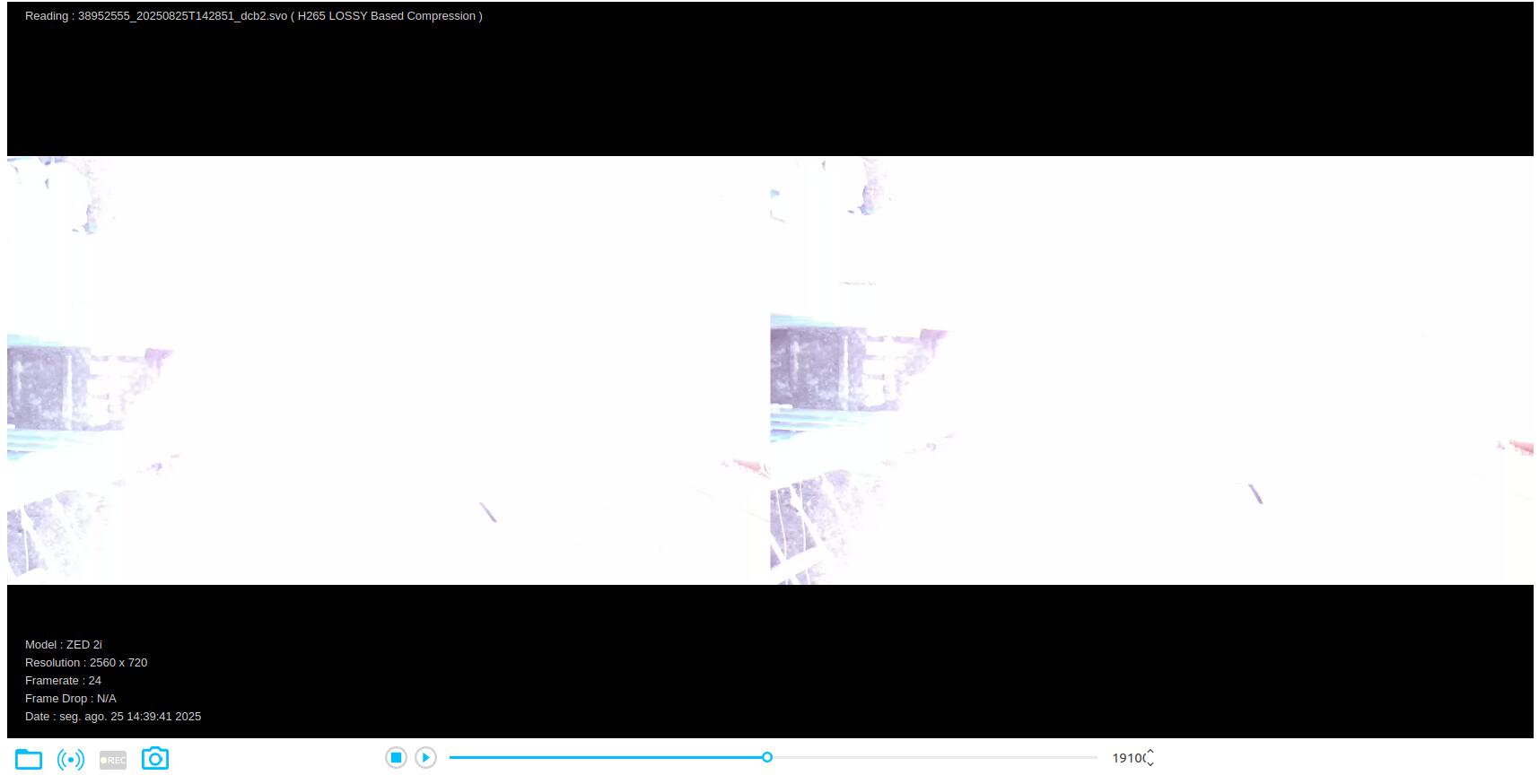

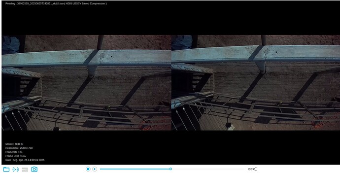

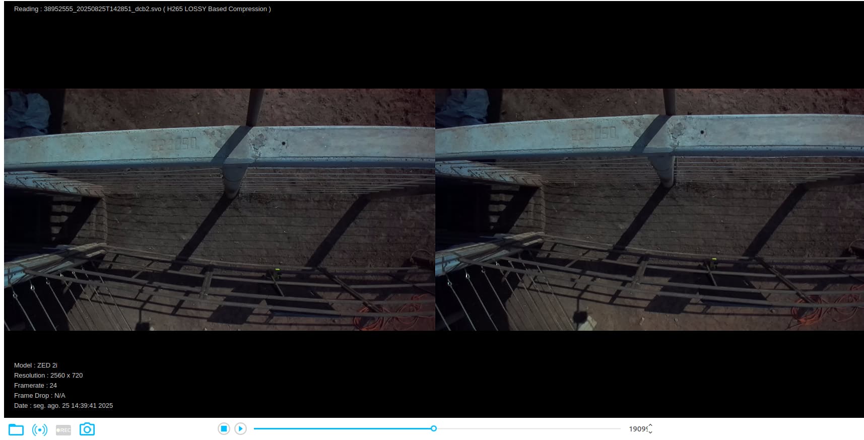

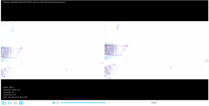

Sometimes a video becomes overexposed, even when using manual settings. Here are some images showing the before and after of the overexposure:

This bug is pretty rare, but I’d estimate we see it every hundred hours or so. Appears to be a spontaneous adjustment of the exposure occurring on the camera itself. Our workaround has been to alert on imagery which has more than x% ‘white’ pixels, which would indicate such an event, then force a cycle on the exposure to get the camera back to where it should have been staying.
