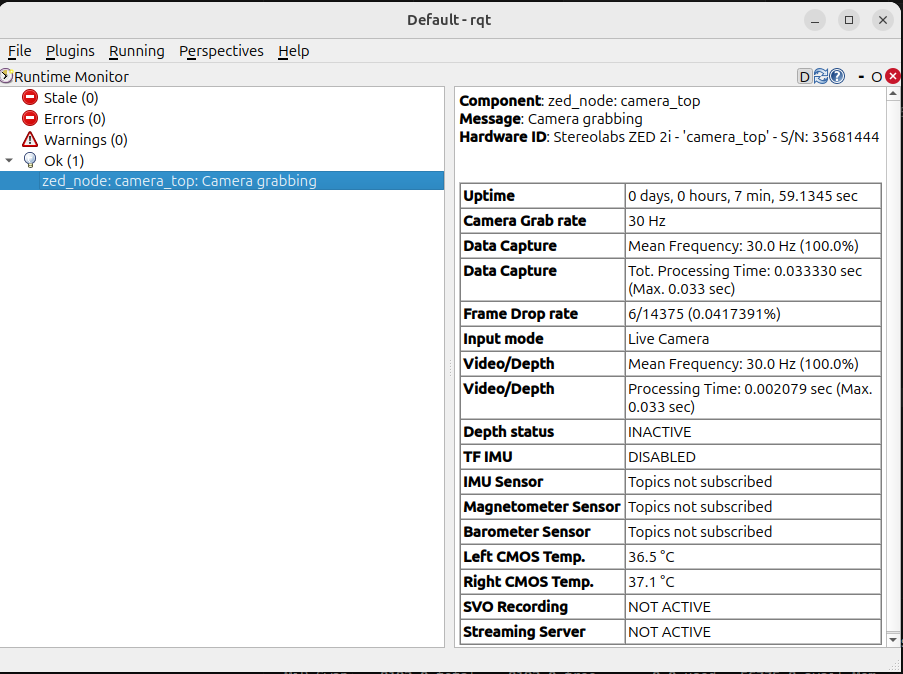

I am using a ZED 2i camera on Ubuntu 24.04 with ROS 2 Jazzy and the zed_wrapper. I configured the camera to run at HD720 @ 30 FPS with depth disabled and publishing only raw images + camera_info.
The node starts correctly and the logs confirm:
Grab resolution: 1280×720
Publishing resolution: 1280×720
Publish framerate: 30 Hz
GPU ID: 0
However, when I check the actual image topics with ros2 topic hz, the measured rate is much lower (around 5–7 Hz instead of 30 Hz). CPU usage is very low (≈3%), the GPU is detected, and the camera is connected via USB 3.1 (lsusb confirms 5000M bandwidth).
average rate: 5.675
min: 0.031s max: 12.867s std dev: 0.58325s window: 4003
average rate: 5.685
min: 0.031s max: 12.867s std dev: 0.58223s window: 4018
average rate: 5.706
min: 0.031s max: 12.867s std dev: 0.58079s window: 4039
average rate: 5.715
min: 0.031s max: 12.867s std dev: 0.57997s window: 4051
average rate: 5.712
min: 0.031s max: 12.867s std dev: 0.57968s window: 4056
average rate: 5.741
min: 0.031s max: 12.867s std dev: 0.57787s window: 4083
average rate: 5.762
min: 0.031s max: 12.867s std dev: 0.57647s window: 4104
average rate: 5.767
min: 0.031s max: 12.867s std dev: 0.57569s window: 4117
average rate: 5.789
min: 0.031s max: 12.867s std dev: 0.57424s window: 4139
average rate: 5.811
min: 0.031s max: 12.867s std dev: 0.57287s window: 4160
average rate: 5.802
min: 0.031s max: 12.867s std dev: 0.57300s window: 4171
average rate: 5.793
min: 0.031s max: 12.867s std dev: 0.57332s window: 4176
average rate: 5.775
min: 0.031s max: 12.867s std dev: 0.57429s window: 4177
average rate: 5.729
min: 0.031s max: 12.867s std dev: 0.58188s window: 4181
average rate: 5.722
min: 0.031s max: 12.867s std dev: 0.58197s window: 4182
average rate: 5.706
min: 0.031s max: 12.867s std dev: 0.58283s window: 4183
Here are my configs:

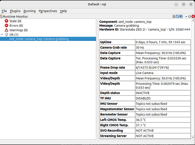

Here are the rqt debug info:
