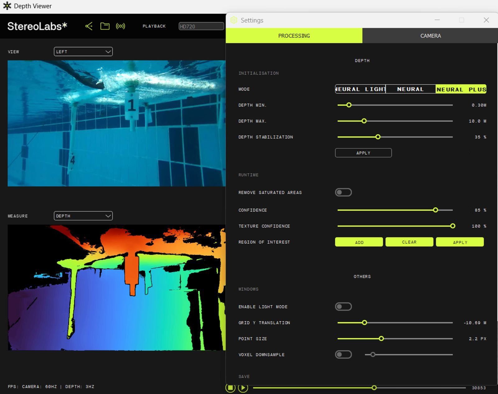

I am using a ZED 2i camera for underwater coral garden measurement and I am facing an issue with measurement accuracy for large objects.
Small object measurements are very accurate and stable, but when measuring longer objects or larger coral structures, the measurements become inconsistent and less accurate. I observed this behavior both underwater and above water, so it does not seem to be a simple calibration issue.
Current setup:
  • Camera: ZED 2i
  • SDK Version: 5.3.0
  • Resolution: HD720
  • Depth Mode: NEURAL PLUS
  • Depth Min: 0.30 m
  • Depth Max: 10.0 m
  • Depth Stabilization: 35%
  • Confidence: 85%
  • Texture Confidence: 100%
I would like to ask:
  1. Is this expected behavior for stereo depth when measuring long objects or larger scenes?
  2. Does underwater refraction significantly affect large-scale measurements with the ZED 2i?
  3. Are there recommended settings for improving long-distance or large-object measurement accuracy?
  4. Would using point cloud measurements provide more stable results than direct depth measurements?
  5. Is there a recommended underwater calibration or correction method for accurate large-scale measurements?
The issue mainly appears when the measured object becomes longer or farther from the camera. Small nearby objects remain highly accurate.
