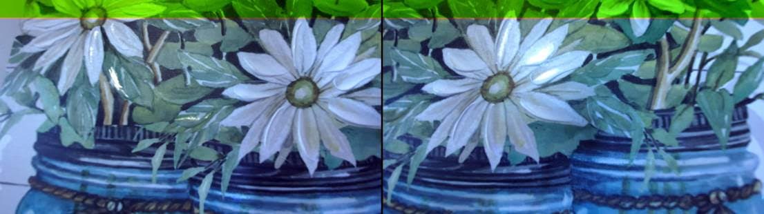

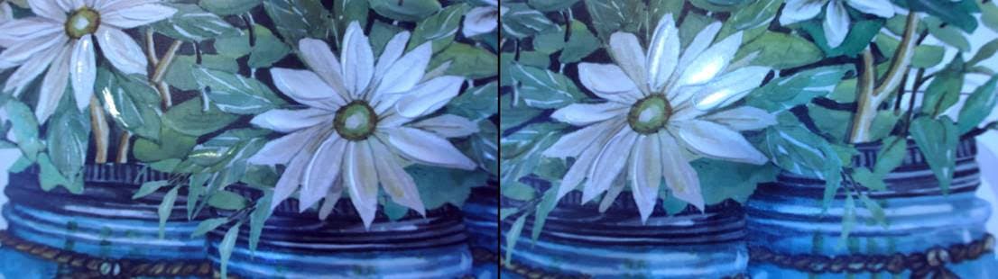

Basically our camera is surrounded on either side with some netting material which can be seen along the left and right side of the left and right image respectively.
These images were taken 9s apart, during that time the service was restarted (i.e., restarting zed-open-capture’s process). Notice how initially the netting is covering more of the left image than after the restart where it is back to the normal position. I want to stress that the netting did not move.

In our accelerated testing we took many pictures of this painting. 99%+ we captured this region:
However, ~1/10,000 using zed-open-capture we saw the left image shift left. The right image remained in the correct position. There were no physical changes, and on the next iteration it returned to the correct position.

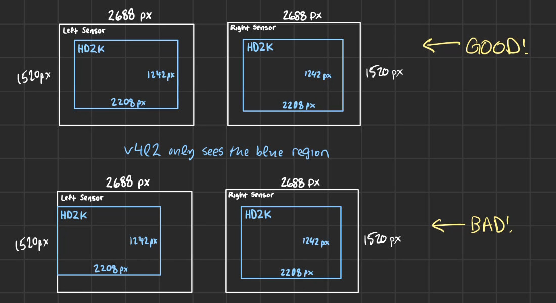

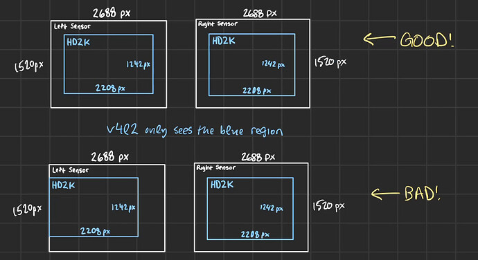

We cannot explain why this happens, but experimentally we are convinced that the left region of the saved image is shifted on the sensor as such:
We are solving it by switching to ZED SDK.
