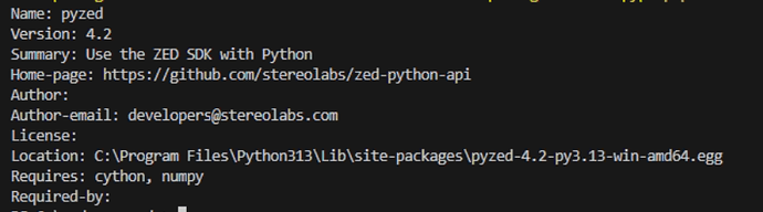

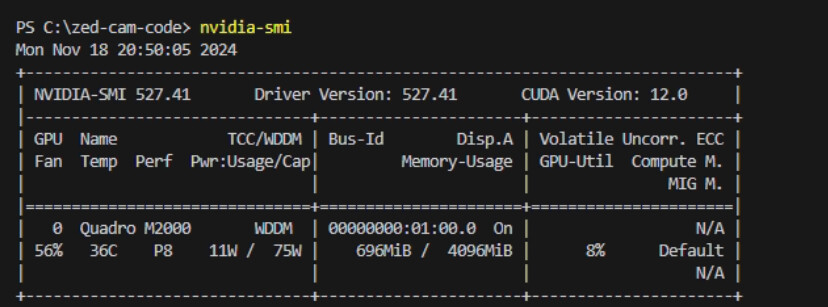

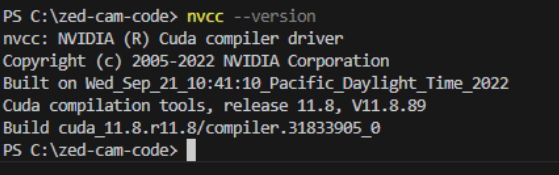

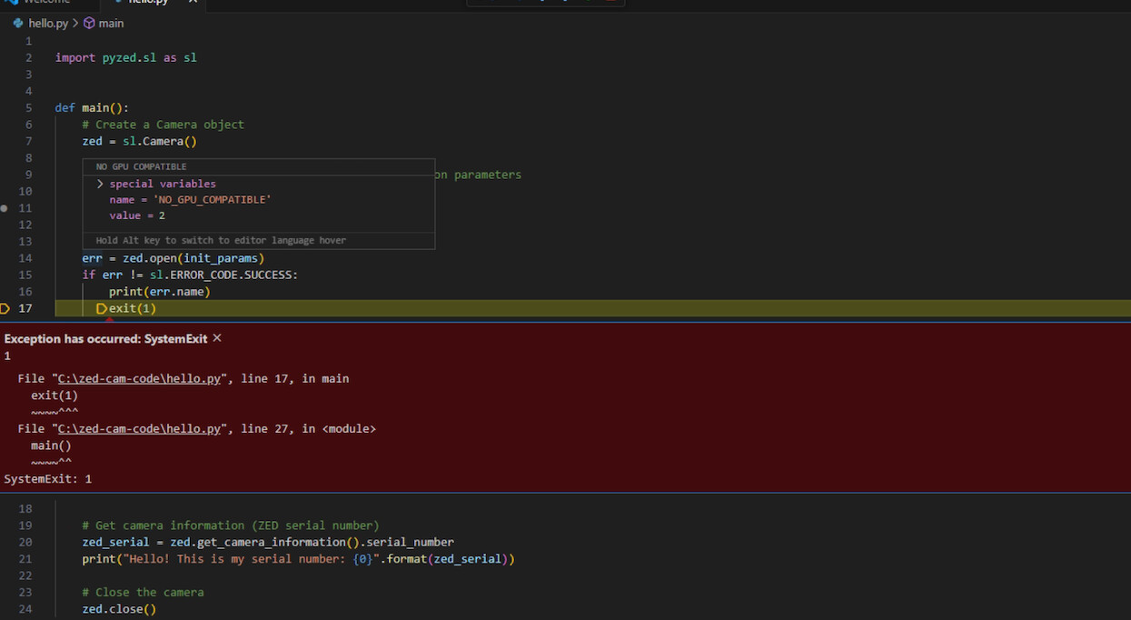

Hi @Myzhar
I am encountering the NO_GPU_COMPATIBLE error when attempting to run my application. Below are the details of the issue and the environment:
System Setup:
Request for Assistance:
  1. CUDA Version:
  • Should I change my CUDA version? If yes, please recommend the version compatible with my setup.
  1. New GPU Purchase:
  • I am planning to upgrade my GPU. Could you suggest a GPU model that ensures compatibility with the latest CUDA and supports high-performance workloads?
Additional Information:
I am open to recommendations for both resolving the current issue and future-proofing my setup for similar tasks.
Hi @karthikreddy157
the NVIDIA Quadro M2000 is based on the old Maxwell architecture that is no longer supported by the ZED SDK.
