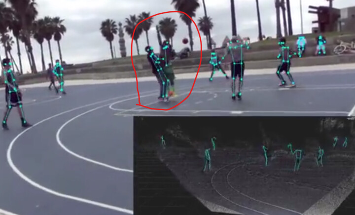

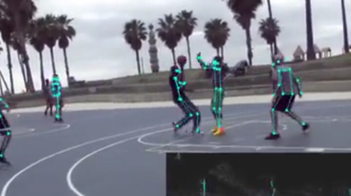

I am also noticing this similarly on your zed body tracking page’s videos. When two users collide the hand goes down.
It was like this a couple of frames prior:

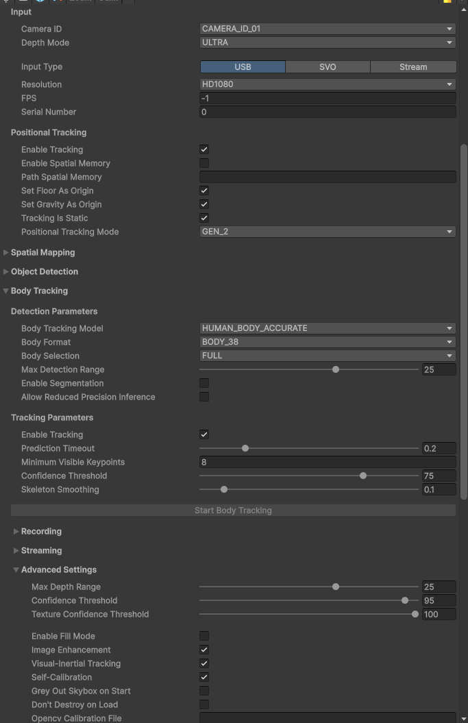

Here is our current settings:
Main improvement:
Try to use NEURAL_LIGHT or NEURAL as the depth mode.
You are using ULTRA, a deprecated mode with ZED SDK v5.1 that is still using the old Stereo processing instead of the new AI-based.
