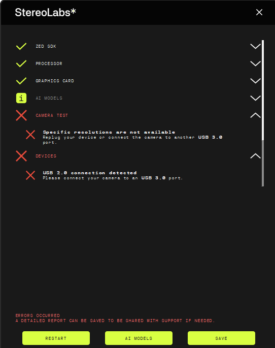

  • Confirmed USB 2.0 speed via USBDeview
  • Observed Sensors MCU invalid serial number in ZED Diagnostic Tool
  • Reinstalled SDK and drivers
  • Previously worked fine on Jetson Xavier
And here is the diagonstic results.
Given these, I suspect the built-in USB cable or connector may be degraded (e.g., USB 2.0 lines working, but USB 3.0 lines not).

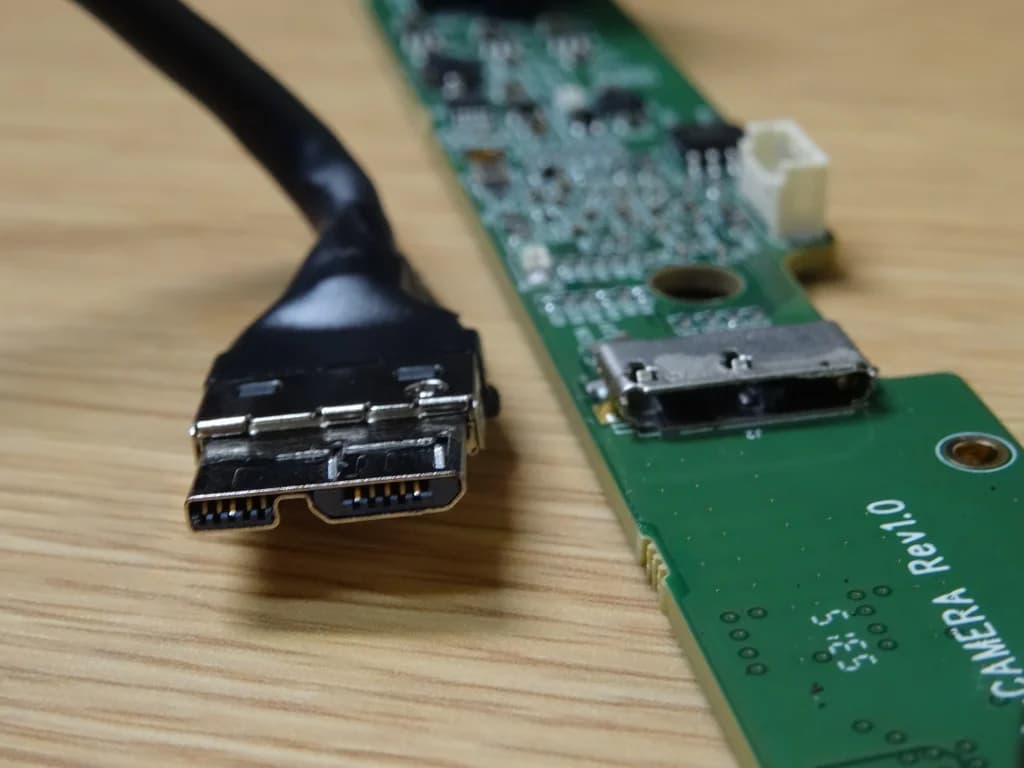

Hi @easynotsoeasy
If the camera is connected to a USB3 port, then it’s possible that the cable is damaged and the USB controller switches to USB2 mode to provide a more reliable connection.
The ZED 2 is no longer in production and We do not provide repair/replacement service for cameras out of warranty.
You can try to unmount it and we do not provide repair/replacement service for cameras out of warranty.
You can try to unmount it and replace the cable by following this unofficial guide.
Thanks @Myzhar
Can you atleast suggest me any place where i can get the cable from?
Or what type of cable would I need? ( i.e : what sort of connection does it have with the pcb?)
It’s a standard USB3 cable with USB3 micro B connector for high-speed communication. You can find it in electronics stores.
