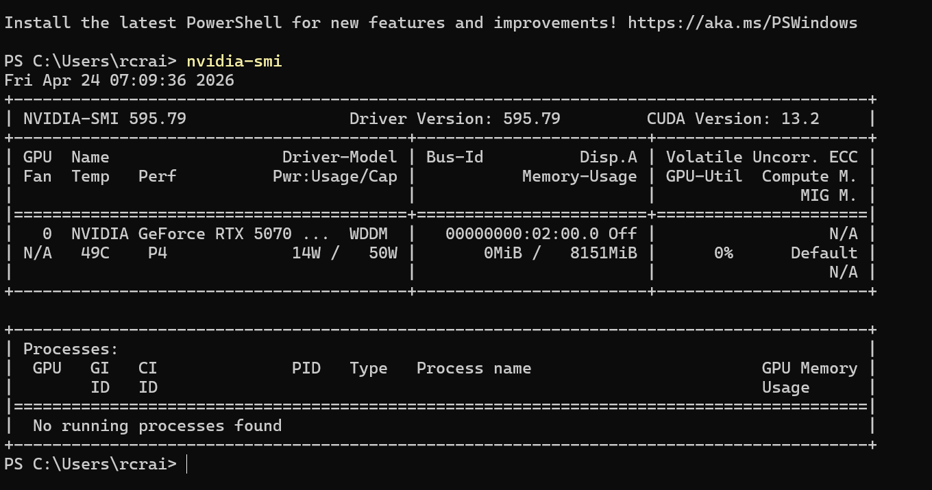

For context, I am already running:
  1. the latest SDK (5.2.3) ,
  2. Nvidia driver (595.79)
  3. and Cuda (13.2).

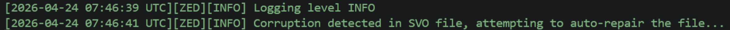

Not only am I unable to view these recording. I can’t seem to even open them in code using the python API.

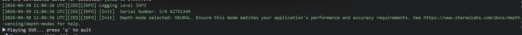

I can confirm that updating the SDK to the new version resolves the issue.
I was able to play a recording that was 14GB and another that was 13GB.
Additionally I tested the python API and found there to be no issue processing either recording.
