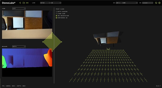

I tried to use the new ROI draw feature of 3.0.7 but do not understand how and where to draw the ROI. When I press “Add” in the settings panel, the ROI is displayed in between previews and I can’t do anything with it.

Normally, you should move the vertices of the polygon on the RGB image to select the area to be excluded from the computation.
The image that you displayed is not expected. What OS are you using?

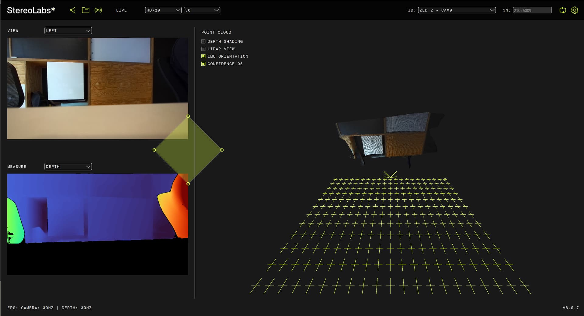

Sure:
This is on Win11 Pro

I figured out what the issue is. When you have scaling on in windows display settings, it doesn’t work anymore. You have to set the scaling to 100%
