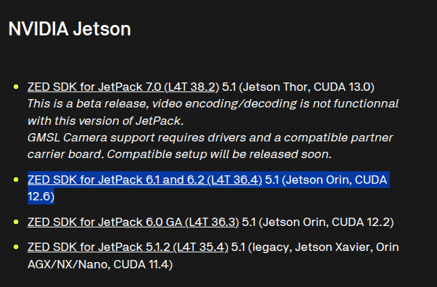

Yes, you must install the ZED SDK for JP6.2:

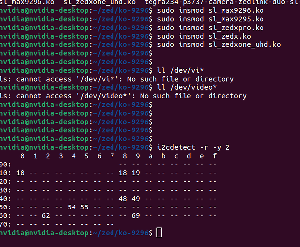

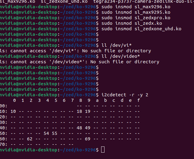

I made modifications based on the source code of version 1.3.1(https://github.com/stereolabs/zedx-driver), but the “video” node did not appear under the “/dev/” directory.
My operation steps are:
README.md (11.1 KB)
1、sudo cp tegra234-p3737-camera-zedlink-duo-sl-overlay.dtbo /boot/
2、sudo cp zedx_*.isp /var/nvidia/nvcam/settings/
3、sudo cp Resources/nvidia_364_fix/R36.4.x/libnvisppg.so /usr/lib/aarch64-linux-gnu/tegra/libnvisppg.so
4、sudo /opt/nvidia/jetson-io/jetson-io.py. Add “Jetson All Camera ZED + ZED Link Duo“
5、Reboot the Jetson
6、Connect the cameras
7、 sudo insmod sl_max9296.ko 、sudo insmod sl_max9295.ko、 sudo insmod sl_zedxpro.ko、sudo insmod sl_zedx.ko、sudo insmod sl_zedxone_uhd.ko
The dmesg information:
log.txt (68.8 KB)
And there is no “video” node under the directory /dev/
