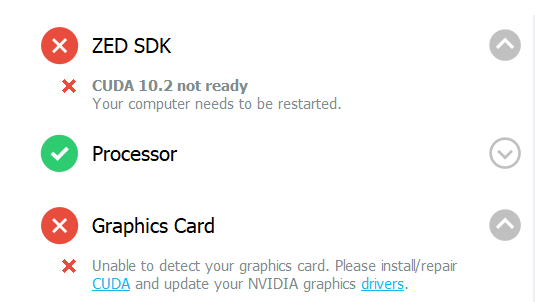

After installing ZED SDK 4.0.8 I get some error messages in the diagostics tool (already restarted):
But the ZED Depth Viewer still works :thinking:
That’s not ideal, but if Depth Viewer and the samples (Program Files (x86)/ZED SDK/samples/bin) work, I think you’re good to go.

My GPU is Quadro M2000M
It’s indeed not the most recent, which is probably why Diagnostic has issues.
If you’re not using too demanding settings though, you may get results with it.
