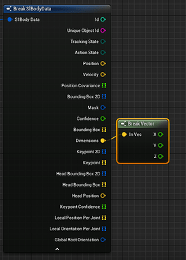

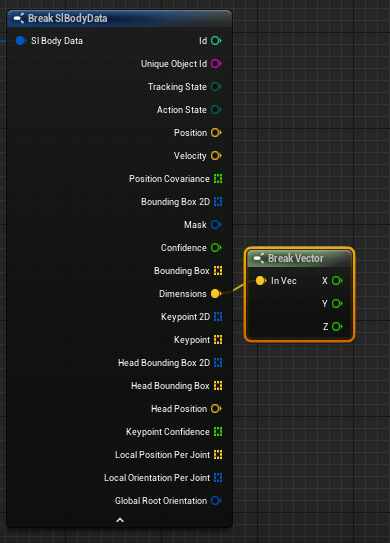

Are the dimensions in BodyData given in cm? As I understand it, the 2nd value is at least an approximate height of the user?
I think the dimensions are in meters even though we pass them to UE5, but at worst it’s a x100 ratio, it should appear obvious when you test.
Which second value are you talking about? You could get by by using the height in Dimensions, but this value will change if the subject is standing or sitting, or even occluded by the camera if the fitting is not enabled.
