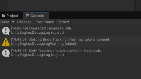

1. Unity Console at startup
This is the screenshot of the console after startup and the ZEDView went blank
