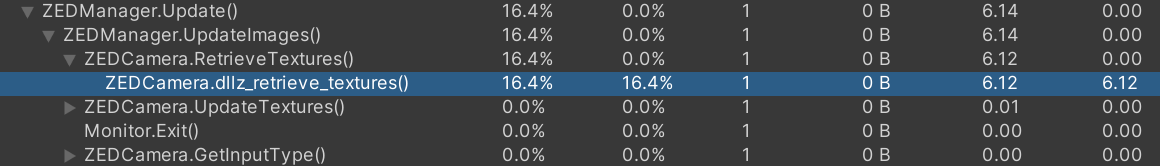

We are using ZED Mini cameras for a custom built AR headset. The application is built with the help of the Unity plugin and runs on Windows. We use the images of the ZED Mini cameras for passthrough. Generally it works.
The only issue we have is performance. We are aiming for at least 60 fps, which means we have a frame budget of 16 ms. The process of retrieving the image textures is already taking about 6 ms (with HD 720 resolution and the camera set to 60 fps), which means more than a third of the frame budget. As you can see in the screenshot, the call to dllz_retrieve_textures is the bottleneck.
Do you see any chance to speed that up in your DLL function?

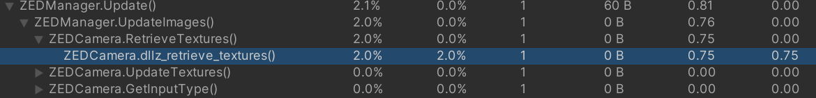

If I run the application on my dev laptop, it takes about 3 ms…grafik
In-editor it runs much faster…
