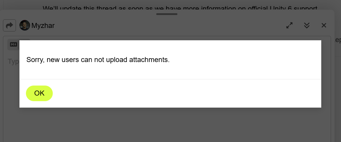

Sorry I’m not able to share my Editor.log file within the forum (because i’m a new user).
Can you do something for this ?

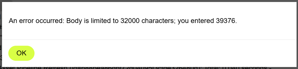

I’m not able to send the whole file content:
So I post only the end part of it:
