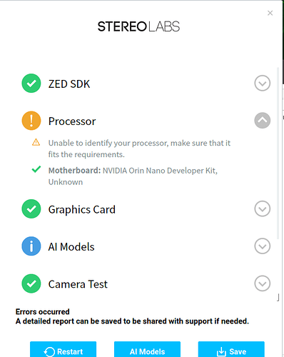

when i run diagnostic,it occures
Unable to identify your processor, make sure that it fits the requirements.
Hi @xxxxll
You can ignore this warning, it’s a false problem usually caused by OS language configuration.

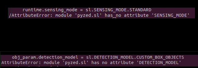

I don’t know why this problem occurred. Can you help me
It seems you are using a very old sample that is only compatible with ZED SDK <= 3.8.2.
You get get updated samples from here : GitHub - stereolabs/zed-sdk: ⚡️The spatial perception framework for rapidly building smart robots and spaces
