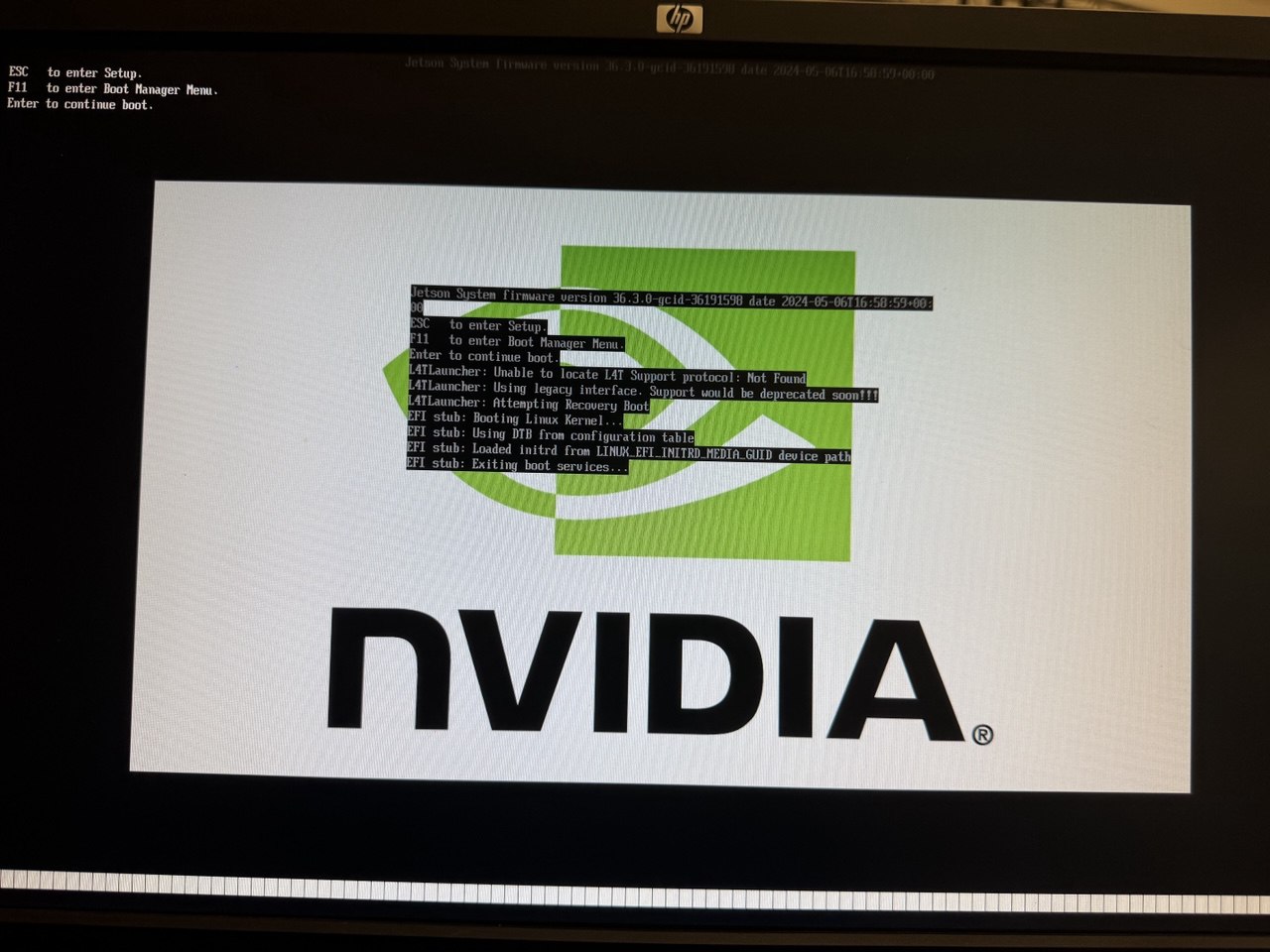

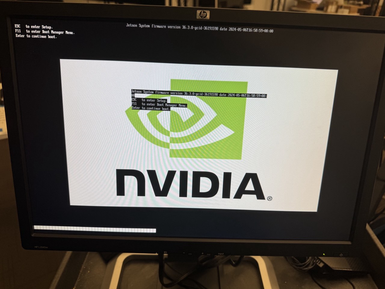

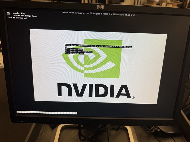

These are the photos of the loading process. After that the black screen with blinking cursor appears.

The file system of the Jetson is no longer valid.
I recommend you reflash the device to recover it:
Wow, that’s unexpected. Is there a way to recover data from the box at all? Can you give any ideas why this could happen, to prevent it in the future? Why it cannot boot from the external USB drive as well?
Normally it can happen if you remove the power without performing a software shutdown.
So there is no way to recover anything from the drive, right, the only option is reflash?
Unfortunately, that’s the case.
