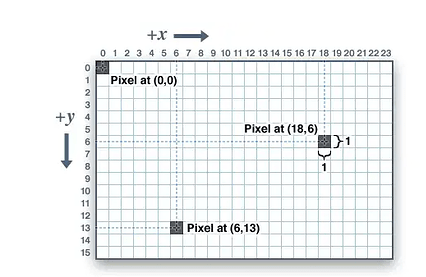

The coordinate system of the original image I use is ( 0,0 ) at the top left, the x direction represents the width of 2208, and the y direction is the height of 1242.
I want to ask what the coordinate system in the corresponding program should choose, is this coordinate_system = sl.COORDINATE_SYSTEM.RIGHT_HANDED_Y_UP ?
What is the meaning of the corresponding [ -3.58743405e + 007.78125610e + 01-1.66326477e + 02-2.39527205e + 38 ]?Is it [x,y,z,rgb]?
The coordinate system of the image I obtained is similar to this.
