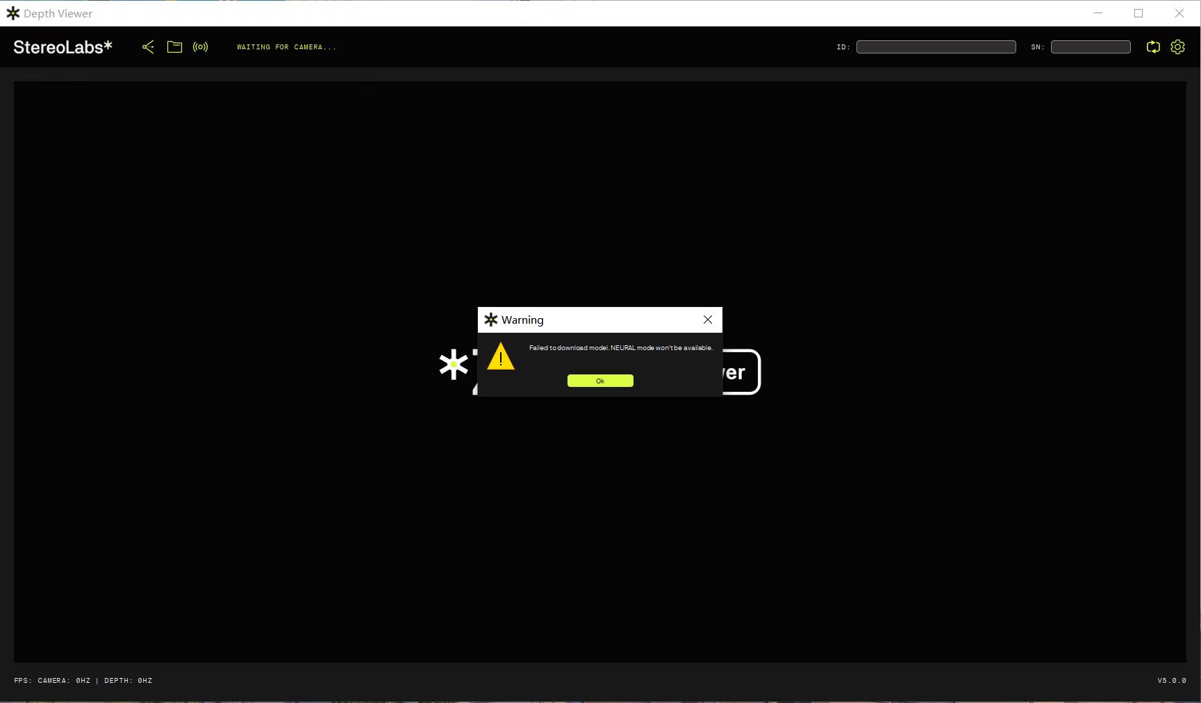

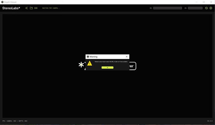

Hi @Jasmine
Do you have a working Internet connection? Are you behind a firewall or using a proxy server?
The firewall is off and no proxy is used
Please open the ZED Diagnostic tool, run a check, then download and optimize all the AI models.
Let me know if this worked.

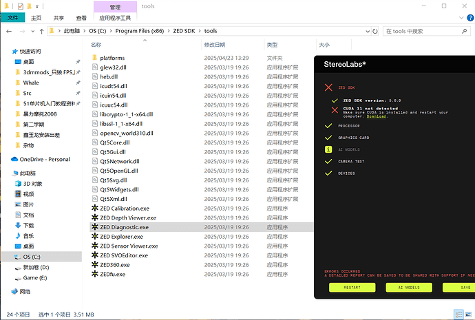

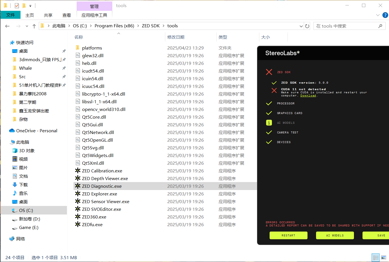

Hi @Jasmine
Please send me the Diagnostic report generated by ZED Diagnostic.
It seems that you did not correctly install CUDA on your machine.
What GPU model do you have?

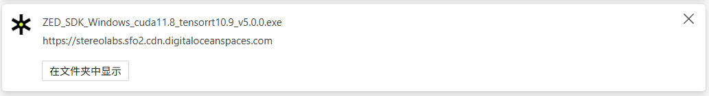

This is the SDK I downloaded, does this version of the SDK only support CUDA11.8, and I don’t have Tensort installed. Similarly, if you want to install it, you can only install version 10.9 of Tensort?
