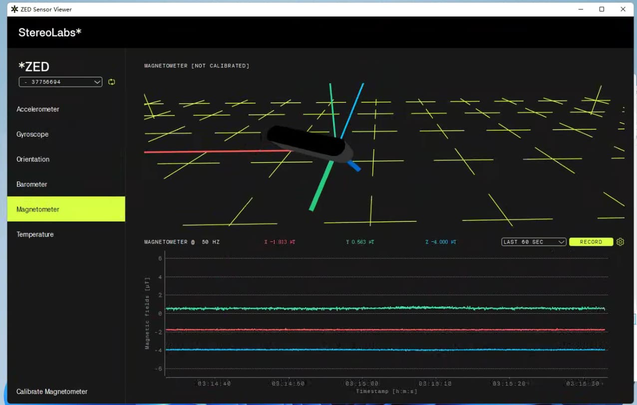

This is the sensor data record of the camera:

I can only obtain the IMU data for now, then set the Y value to 0 and record this data as the camera’s pose for positioning purposes. However, I am concerned that other values may also shift in the future, or that there may be issues with other hardware or software data, which could lead to unavoidable errors at that time.At the same time, do the two commands above not working indicate a hardware issue?
Will this drift be affected by the magnetic field?

No, magnetic measurements are not used for the orientation estimation
