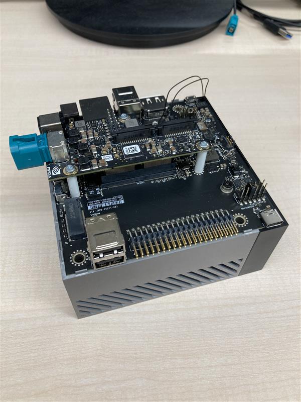

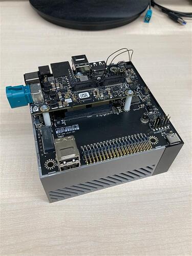

Hello!
I’m trying to use Zed X on Nvidia Orin developer kit with Zed link Mono.
I followed this doc and installed driver.
I did the command sudo dmesg | grep zedx but it does not return any information of daemon for zedx. If I used sudo systemctl status zed_x_daemon.service , it said the daemon is loaded and active. Do you have any solutions for this situtation?
I also put log which was generated by ZED_Diagnostic below(sorry, I’m a new user so I could not attach the file itself.).
Thank you.

Hi @satoshi
Who is the manufacturer of this “developer kit”?
There’s no official NVIDIA developer kit for Orin NX modules.
Hi! Thank you for your quick reply.
Sorry,I’m using Nvidia Jetson AGX Orin Dev Kit.
I’m using it with Zed Link Mono.
Hi @satoshi
You are using a ZED Link DUO with an NVIDIA Jetson AGX Orin.
You installed the wrong driver.
Use the command sudo dpkg -r stereolabs-zedlink-mono to uninstall it and then install the correct driver for the ZED Link Duo capture card
Thank you for the reply. It works now! Thank you again.
