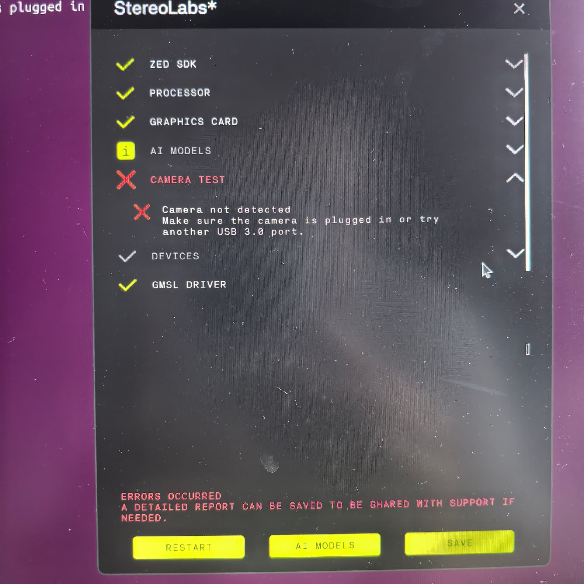

Thank you very much for your reply. May I ask how I can open the ZED Diagnostic tool? Is there any related documentation I can refer to?

Hi @eatpockyboy
Are you working in headless mode with no display connected?
Hi @Myzhar
Yes, I connected to the Jetson development board via SSH and then executed the command line. Is it necessary to have a display connected? I can try connecting a display and see if that works.
But the code in the first topic was run with a display connected.
Please read this support page for the explanation and the solution to your problem.

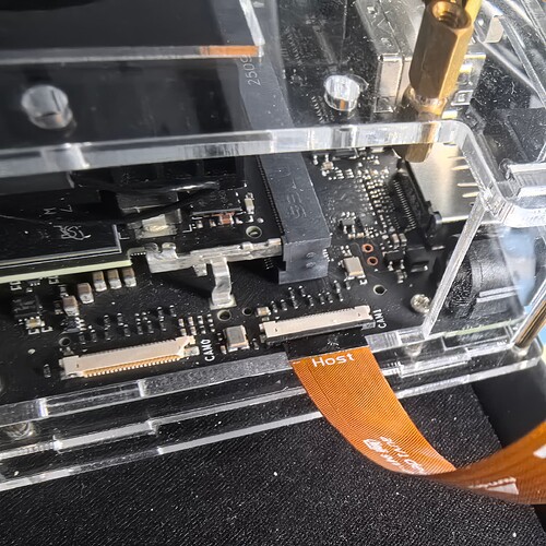

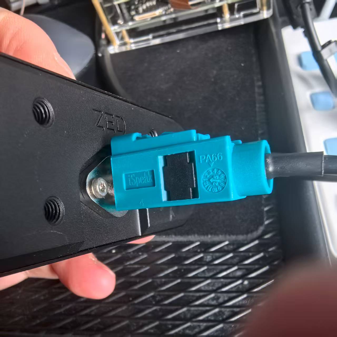

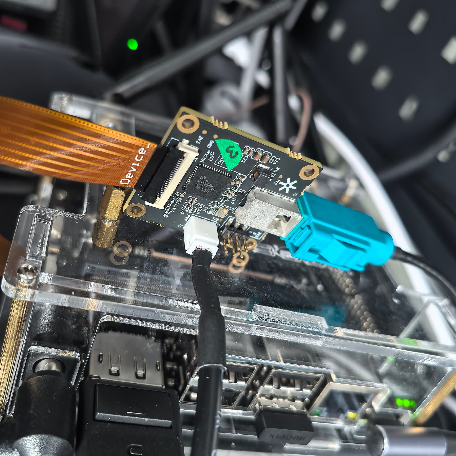

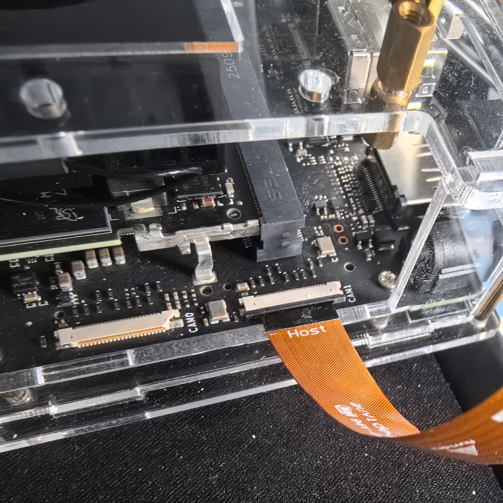

Thank you very much for your help. However, the code in the first topic was run with a display connected. I will upload a picture of the device connections later; please help me check it. Thanks again.
I checked the wiring and found no issues. I measured the mono capture card with a thermal imager and found its temperature reached over 130°C. Our EE’s preliminary judgment is that the mono capture card is burned out.
The official documentation states that the input voltage for the mono capture card is 12–19V, and my power supply is 15V 1A. I would like to ask the ZED technical team to help analyze the cause of the mono capture card failure.
Thank you.
I think this is a clear clue of a damaged card. Please write an email to support@stereolab.com
