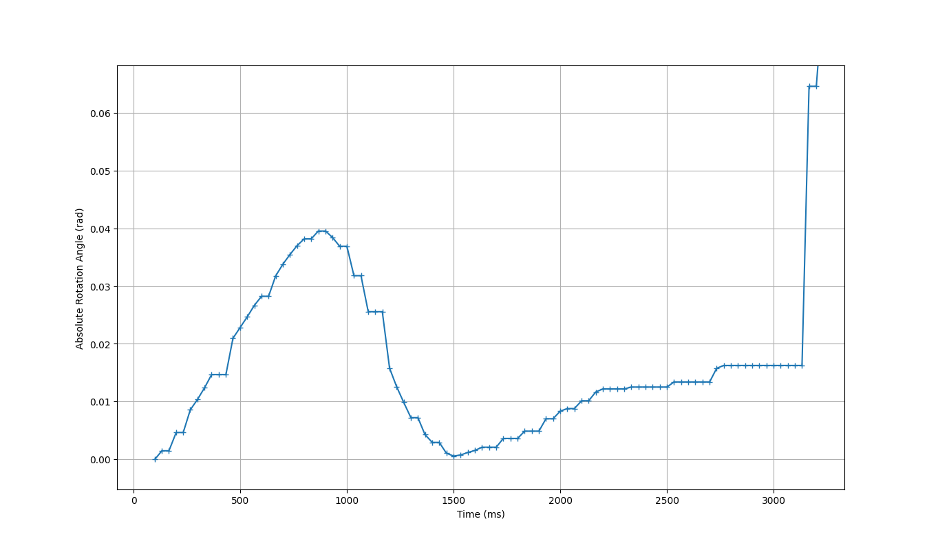

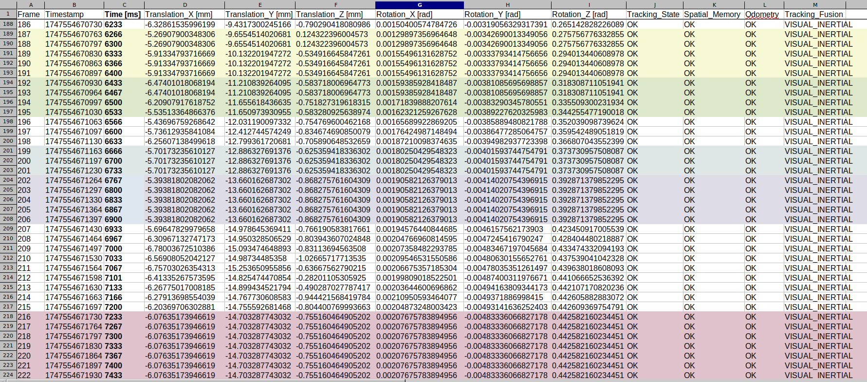

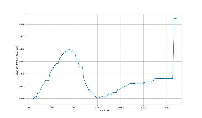

I am doing positional tracking GEN_3 on a svo2 file (ZED-X mini @30hz, Orin Nano) from a desktop using pyzed, and noticed that the poses often take several frames to update (see attached screenshots). This obviously leads to unpredictably long windows with unreliable tracking data. This doesn’t occur with enable_imu_fusion = False.
Is this expected behavior or could there be something wrong with the IMU or SVO recording?

I checked your SVO. It seems to contains a lot of IMU drops. How did you record it ? Is your ZED X driver is up to date ? For recording SVO2 I suggest to use the sample we provide (available at this link).
Your issue is related to this IMU drop. Disabling the IMU fusion give better result. You can disable IMU fusion by setting enable_imu_fusion to false.
