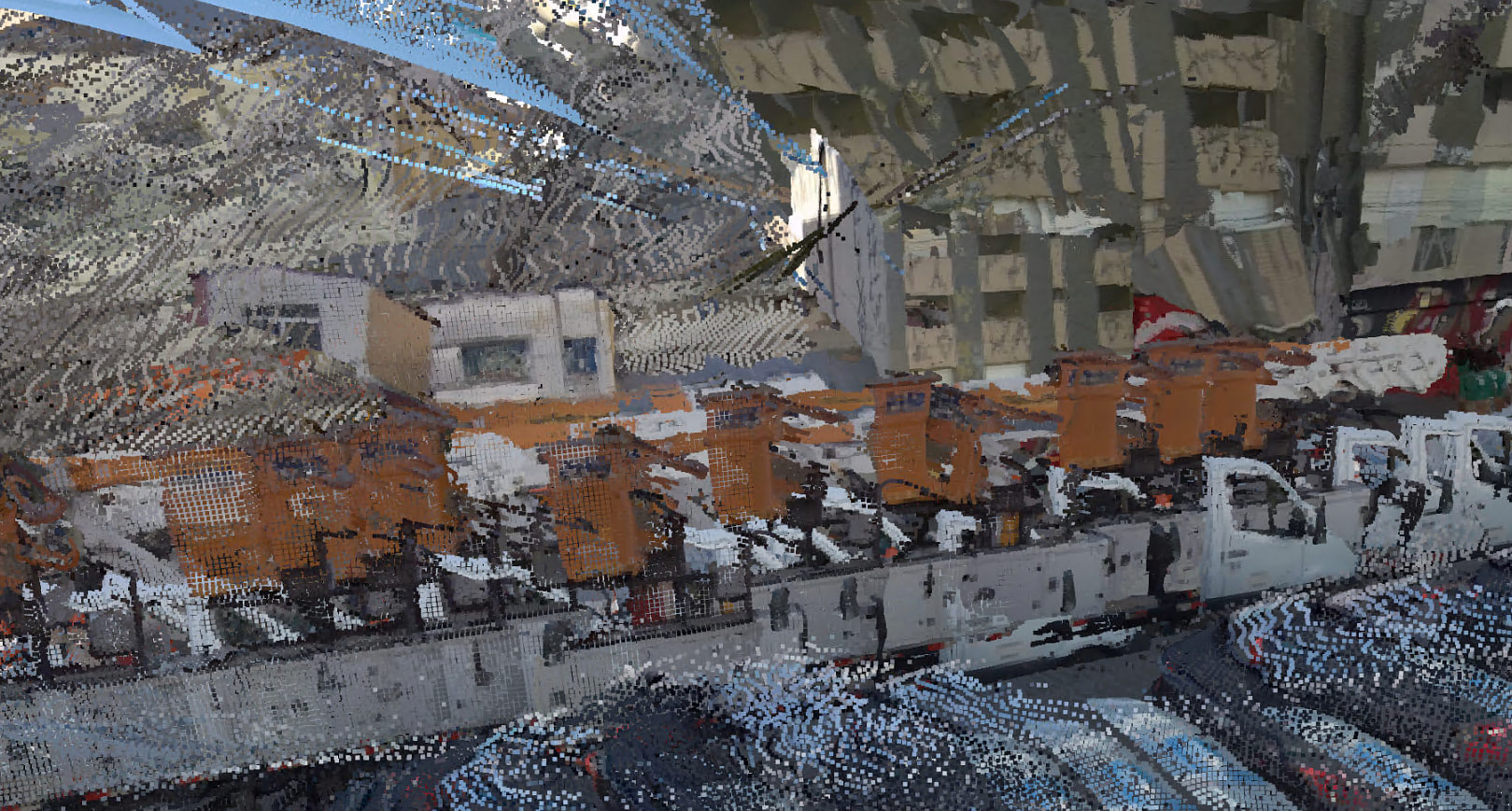

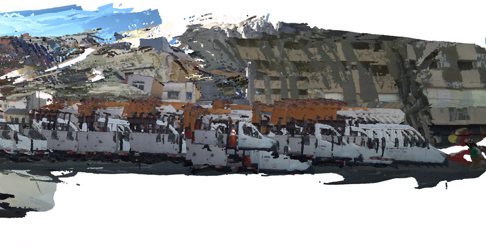

  1. The SDK’s spatial mapping produces very sparse or snapshot-like reconstructions on the side-facing cameras. Visual-inertial odometry appears to struggle with the fast lateral feature motion, and most frames seem to be discarded from the accumulated map.
  2. When I bypass the built-in spatial mapping and accumulate per-frame XYZRGBA point clouds manually using the positional tracker’s pose, the side-camera result exhibits significant drift and “ghosting” over a 3-second clip (~30 m of travel).
  3. Dynamic objects produce artefacts in the fused cloud, as expected for a static-world assumption.

These are the 3D mapping I’ve got so far.
Hi @caiobarrosv
No, the spatial mapping module was designed to manually reconstruct environments.
It’s not optimized to create maps in high-speed conditions.
What optics model are you using? To obtain similar depth accuracy at 20 m, you need a ZED X camera with 4 mm focal length optics.
The ZED SDK Fusion module is not designed to provide this type of processing.
You can surely improve the reliability of the final mapping results by fusing GNSS information with the positional tracking data, but I recommend using external libraries specifically designed to create 3D maps in post-processing after saving ZED streams in SVO format.
