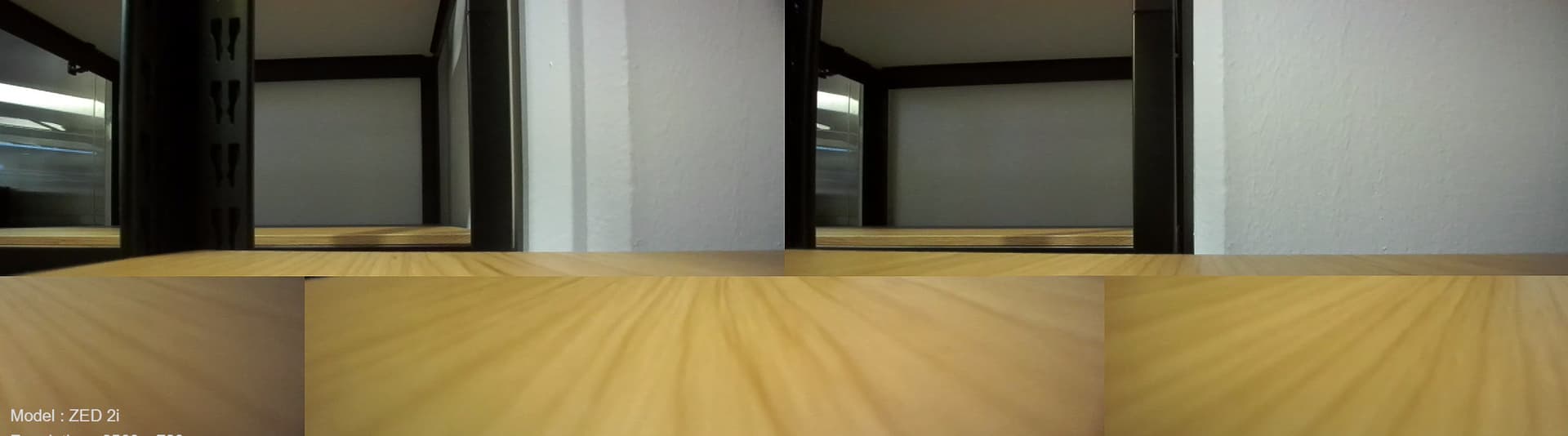

I tried the approach you suggested.
However, I encountered an issue: the SVO file gets corrupted when I run either GStreamer or the local streaming receiver at the same time as the SVO recording.
The corrupted section of the SVO file is shown below:
Hopefully, you can find the area of the corruption. The below area is corrupted.

This is a typical frame-tearing issue with a USB 3 camera.
It’s caused by a buffer overflow in the USB 3 controller because the CPU is overloaded, and it cannot retrieve the data fast enough.

This is not true because this problem only affects USB 3 devices. The ZED X Mini is a GMSL2 camera.
The PC seems to be powerful enough to avoid buffer overflow issues.
  • Is the USB 3 connection stable?
  • Are the screws of the connector strongly strengthened?
  • What’s the length of the cable?
  • Are you using USB 3 hubs?
Thank you for your kind reply.
I simply tightened the screw and switched the USB port, and it worked.
It turns out the camera was connected to a BIOS USB port.
Thanks again!
