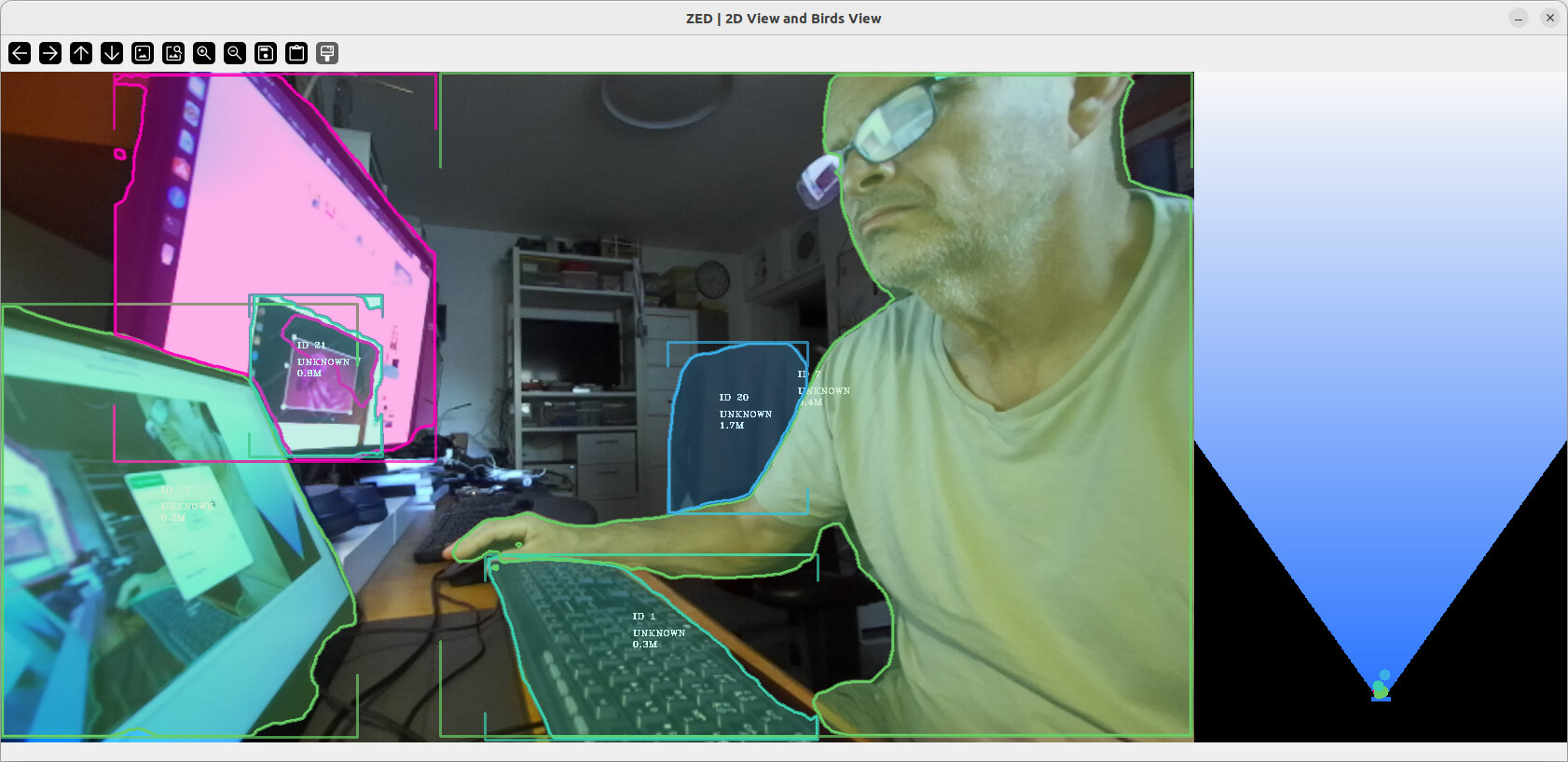

Hi @LuckyJ ,
Thank you for the update.
  1. wrongly displayed: I was expected to see the CLASS ID or CLASS NAME of the detected object based on yolov8/11 pretrained dataset, as it was in all previous releases. The both releases “ZED sdk” and “Ultralytics YoloV8/11” are baselines for my development project in which from time-to-time I’m doing catch-ups test and verification of the baseline. BTW, I’m using the copy of sample folders at /usr/local/zed/samples… Please find a screen copy of my project. You can observe that in each detected object I’m using CLASS ID designated by “o” and distance to object designated by “d” and location of the object designated by “c”, where the data of CLASS ID and distance are provided by the modified detector.py design of ZED SDK releases. In the below particular screenshot there were detected CLASS IDs as following: 63 for laptop, 62 for tv, 66 for keyboard, 41 for cup and 0 for person as referenced in A list of all 80 YOLO classes and its index in JSON format. · GitHub
  1. I can not remember the details of GTK-related error which was displayed in CLI , and was resolved by work-around uninstall/reinstall OpenCV. I will update in a new issue with all the related details when it will occur next time.
  2. pip install ultralytics command also installs torch and torchvision binaries if they are not installed, and they are compatible with numpy 2.2.6 and they do not conflict with the current official SDK release. On the other hand, during the runtime execution, these binaries are less efficient (80msec vs 30msec) than the recommended ones by NVIDIA and Utralytics releases of JetPack 6.2 and YoloV8/11 for Jetson Orin sdk/modules. Please be noticed, In the efficiency of the runtime execution I rely on already optimised pre-trained dataset and torch/torvision binaries.

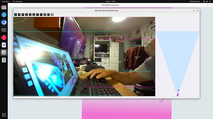

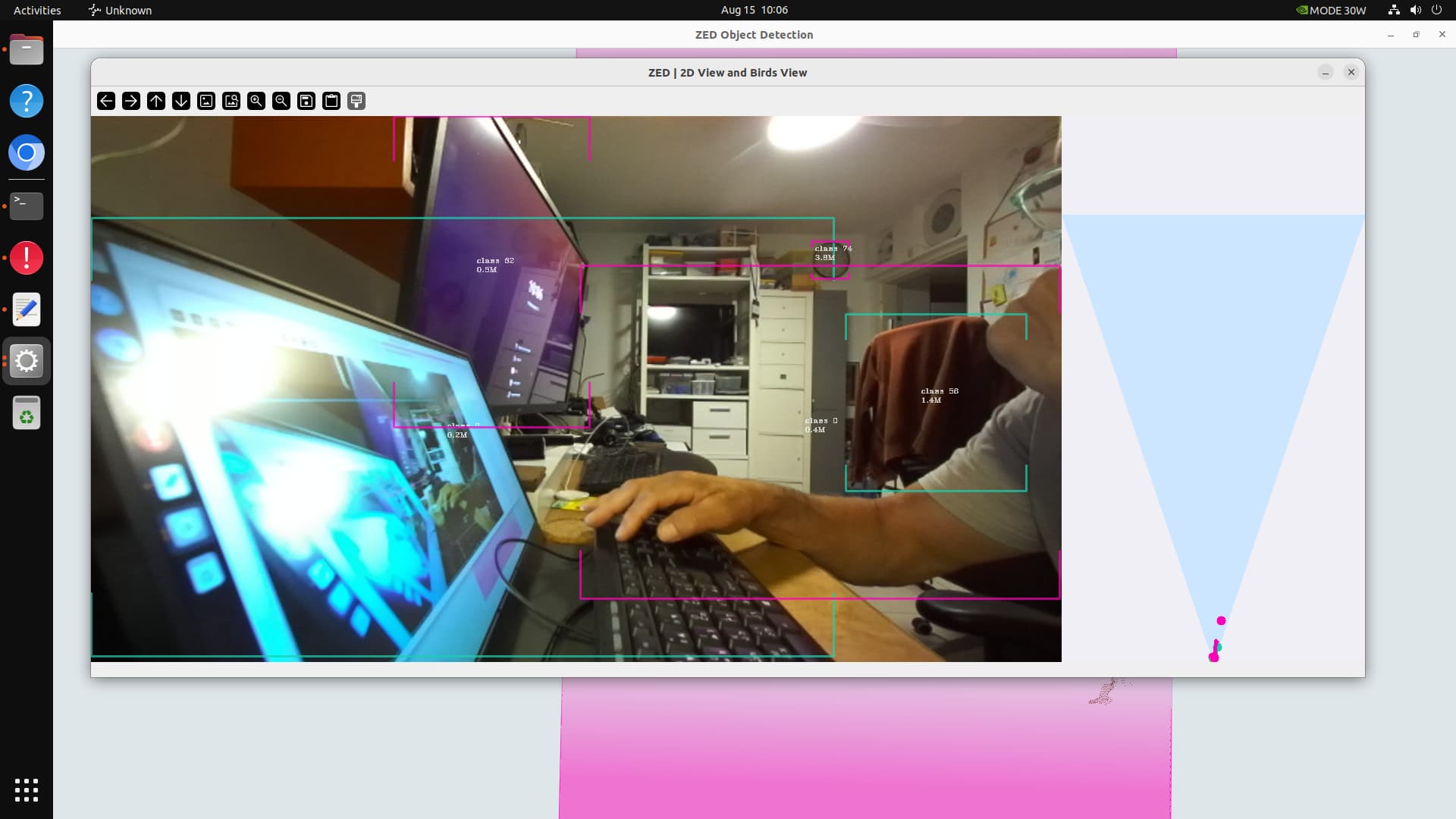

Hello @LuckyJ ,
This may give some more clue where the issue is located.
I’ve re-flashed the board from scratch and used the released sample script in …/pytorch_yolov8/detector.py, which produced an expected result. I wander if the problem is related to the sdk sample code of the object segmentation detection script …/pytorch_yolov8_seg/detector.py. I have used ZED_SDK_Tegra_L4T36.4_v5.0.5.zstd.run
Hello @izidorg,
Thank you for getting back to us!
I understand now the remaining visualization issue that you are describing:
  • the pytorch_yolov8_seg displays:
    • the tracking ID
    • the name of the detected object (unknown since it’s a custom model and the ZED SDK has no knowledge about what it represents)
    • the distance
  • while the pytorch_yolov8 displays:
    • the class idx (an integer)
    • the distance
We’ll uniform that in the next release, by having as before the class idx + the distance and still add the track id when the tracking is enabled.
In the meantime, If you want to replace the UNKNOWN with class idx in the pytorch_yolov8_seg sample, you can replace str(obj.label) with f"class {obj.raw_label}" in pytorch_yolov8_seg/cv_viewer/tracking_viewer.py#L127.

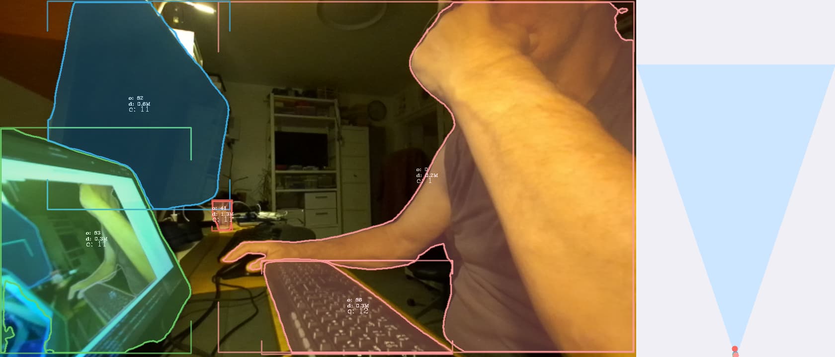

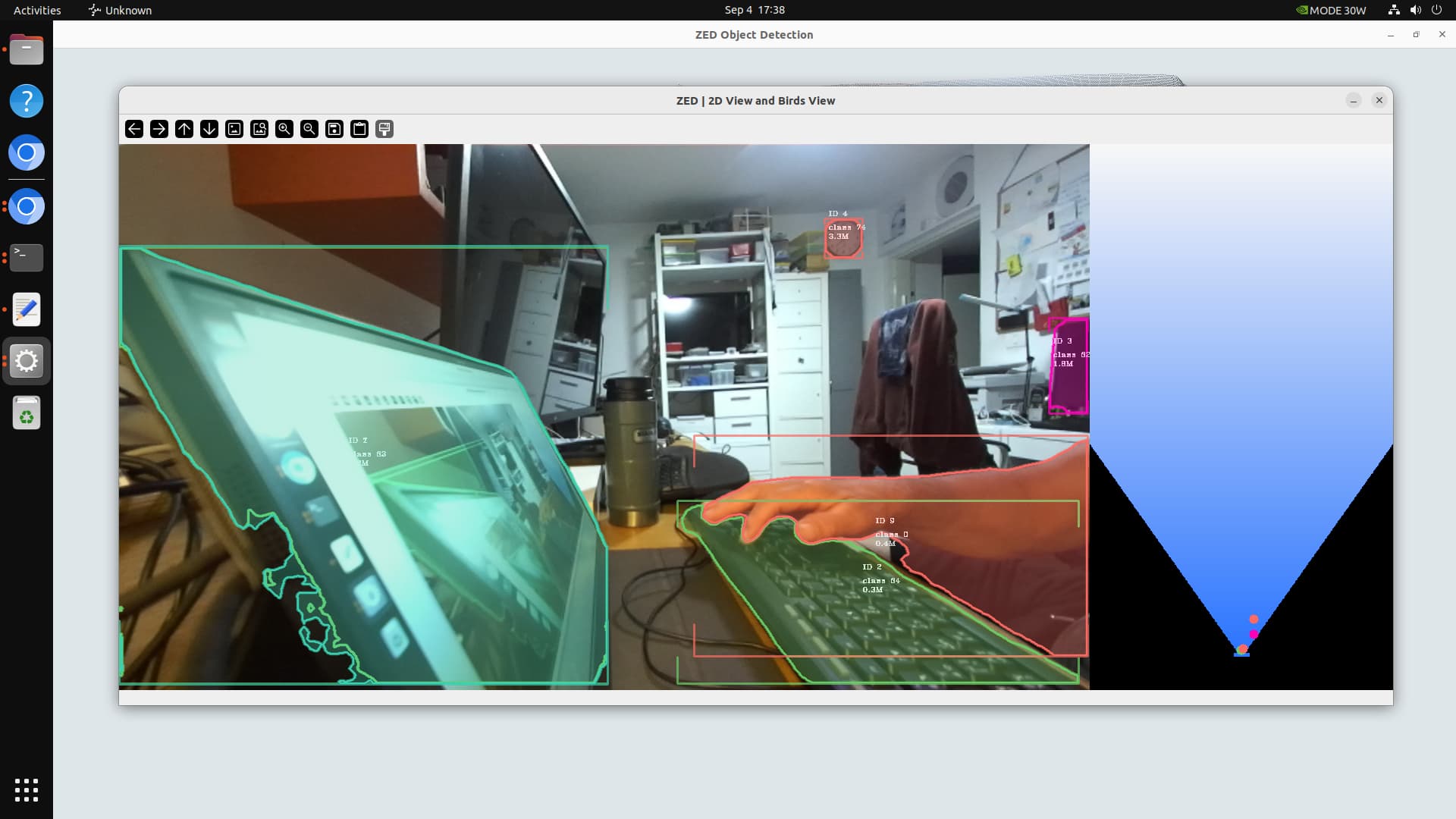

Hi, Thank you! Will get back soon with my verification on the above.
Hello LuckyJ
This is it! The fix worked as expected!!!
