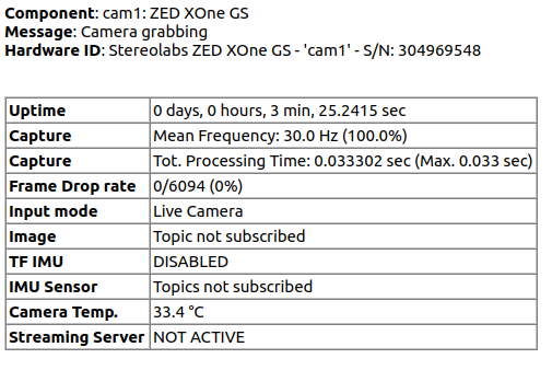

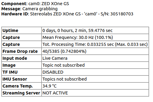

Please send a screenshot of the diagnostic.

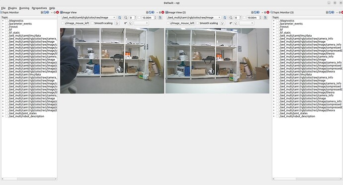

Have you tried to use rqt to call the service instead of a CLI command?
the file is diagnostic report and rqt screen which doesn’t look like there’s problem
ZED_Diagnostic_Results.json (22.5 KB)

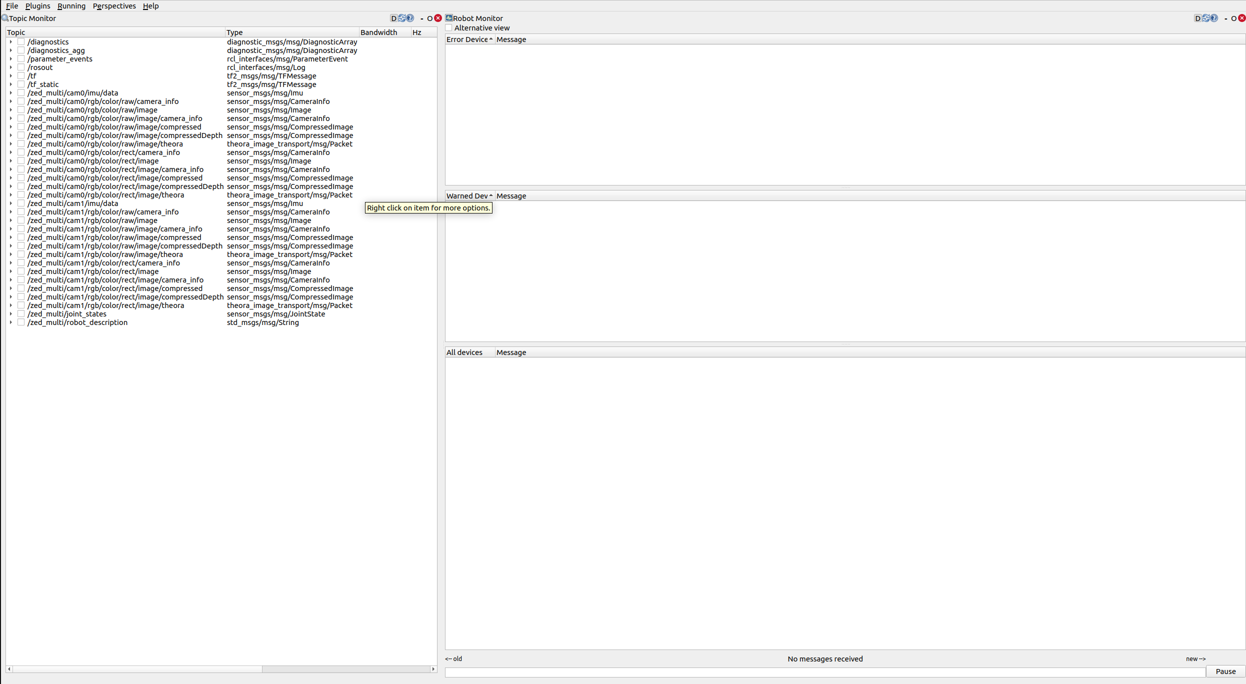

Please take a screenshot of the Node Diagnostic in rqt and share it here.
It looks like Diagnostics viewer(Robot monitor) is substitute for Runtime monitor for ROS2 Humble
For using Diagnostic viewer in Robot tools, I installed like below:
sudo apt update
sudo apt install ros-humble-diagnostic-updater \
                 ros-humble-diagnostic-aggregator \
                 ros-humble-rqt-robot-monitor
but monitoring gui is not working like this,
and below is result of
ros2 topic echo /diagnostics

No, this is a diagnostic collector. For single node diagnostic you must install and use “Runtime monitor”: sudo apt install ros-humble-rqt-runtime-monitor
below is runtime mornitor screeshot
The ZED X One nodes are working as expected, but you cannot record SVOs using the ZED ROS2 Wrapper because this feature is not enabled for the ZedCameraOne component.
