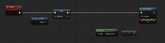

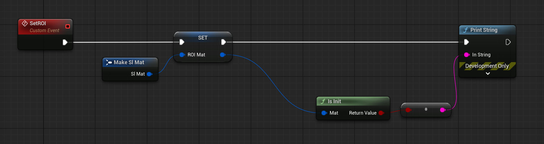

I’m declaring a variable of type SI MAT as needed in the “set region of interest” and trying to act on it with functions issued from StereolabsMatFunctionLibrary.h . But all the functions make the editor crash. For exemple, just trying to print the result of the “Is init” function make the editor crash with error:
Unhandled Exception: EXCEPTION_ACCESS_VIOLATION reading address 0x0000000000000050
sl_zed_c
UnrealEditor_Stereolabs!USlMatFunctionLibrary::execIsInit() [E:\RepertoireDeTravail\CosmoAv\Mozart\UnrealProject\zed-UE5-main\Plugins\Stereolabs\Intermediate\Build\Win64\UnrealEditor\Inc\Stereolabs\UHT\StereolabsMatFunctionLibrary.gen.cpp:931]
Can you help me on this subject please?
Can you show me how you initialize the sl mat please?

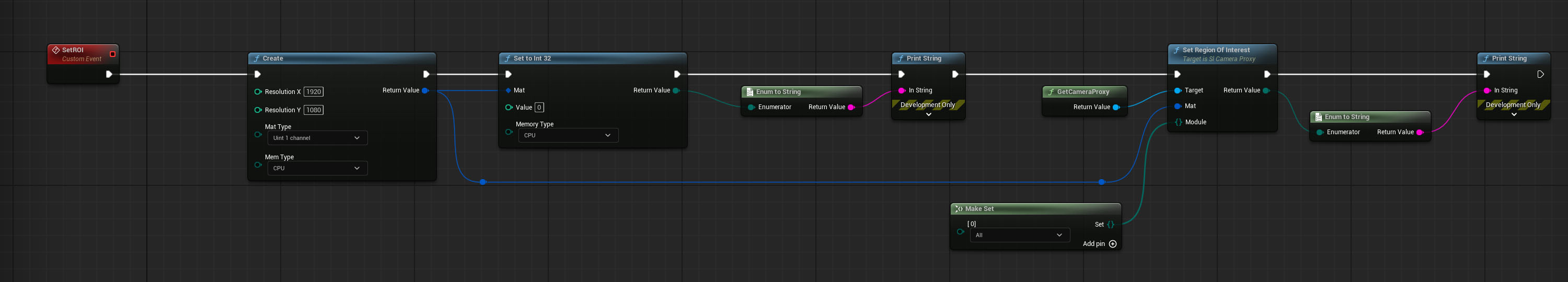

I just realised it is very complicated to manipulate slMat from the blueprint with the current version of the plugin.
So I added some utility functions. You can use it like that :
Stereolabs Support

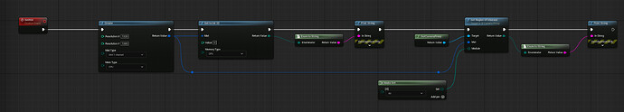

Hi Benjamin,
On my side, this compile. No more crash.
But I can’t make it work.
First, maybe the problem, I don’t have the “Set to int” function. Only a “Set to Int 32”.
I’m doing the same thing as you, in your last post, except the “Set to int” that I replaced with the “Set to Int 32” one.
I’m starting the project with “Start Object Detection Automatically” set to “False” in “BP_skeleton_Visualizer”.
Then I execute the code you give me to set the region of interest, with “Resolution X” set to 1920 and “Resolution Y” set to 1080 (I’m setting also the “Resolution” init parameter of the camera to “HD 1080P” in “BP_Z_Initializer”.
Every function returns “Success”.
And after I execute " EnableOD" in “BP_skeleton_Visualizer”
I’m trying with a value of 255 and also with a value of 0 for the “Set to int 32” function, considering that one of these two values should stop the detection by making a black region of interest. But in both cases, the detection works after enabling it.
Do you think the problem comes from the “Set to int32” function?
