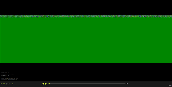

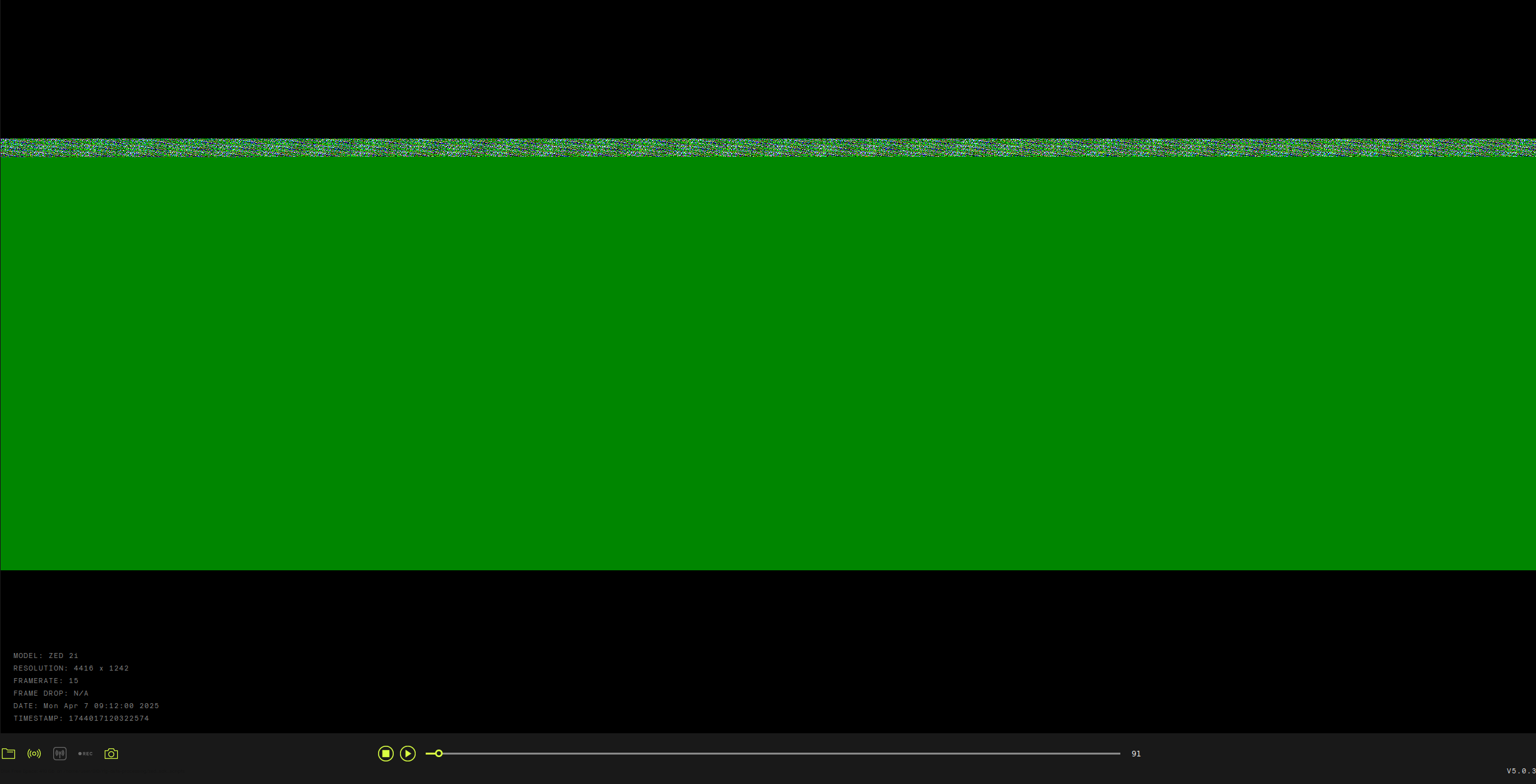

I have a particular use case where I collect videos with lossless compression and then, to save space when storing, I might want to compress them with lossy compression. For this I run a script which takes a video as input and re-records it (code at the end).
This used to work for ZED 2i with sdk 4 but I am not being able to make it work for ZED X in sdk 5. To try to understand whether it is a camera problem or an SDK problem, I tried to use a video filmed with ZED 2i and I couldn’t do it either. So I think it’s an sdk5 problem.
Below is the code and a frame from the resulting compressed video which is nothing more than a sequence of green frames. I’m currently using SDK5.0.5

Hello @troliveira,
Thank you for the report and for the script! Having a script which helps us to easily reproduce is highly appreciated!
As you reported, we confirm that their seem to be a regression in the 5.x releases (up to 5.0.5) regarding recording a recorded SVO.
This has been noted on our side and added to the backlog for the next release.
Please keep an eye at the release notes when we release the next patch/minor
Knowing that recording a recorded SVO is important for you, we’ll also make sure to add this use case in our tests
