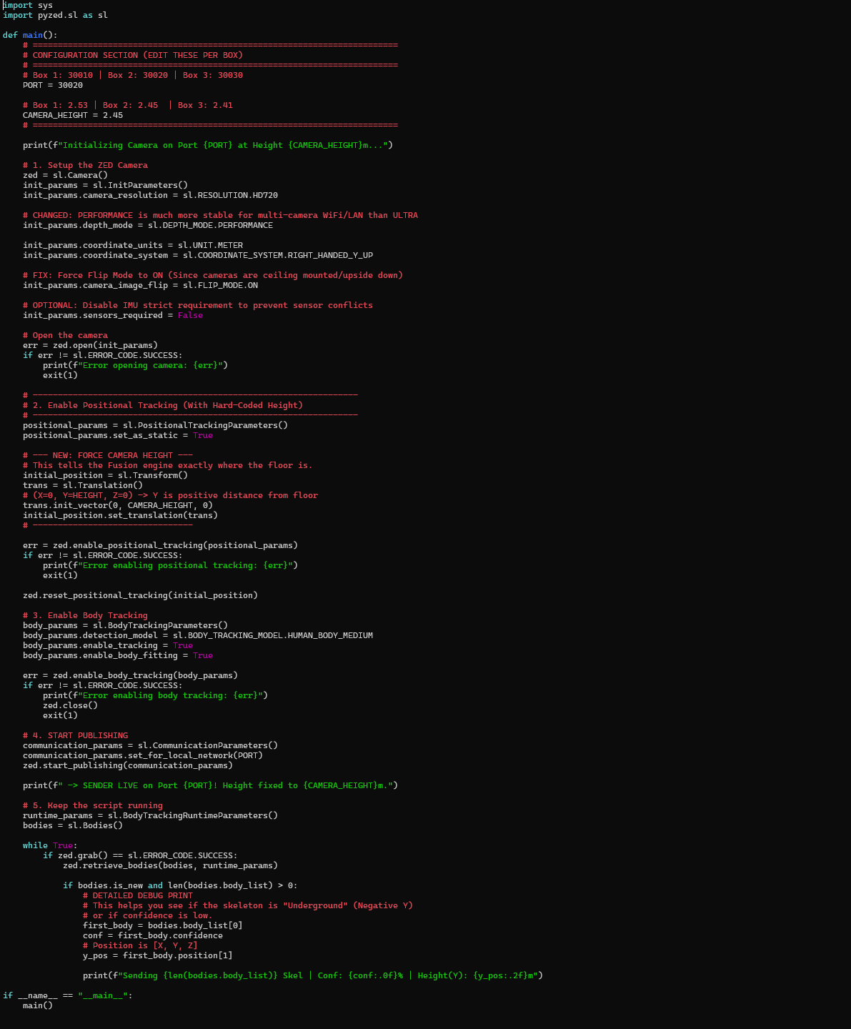

i have a sender script in: “/usr/local/zed/samples/body tracking/multi-camera/python/”
the script runs

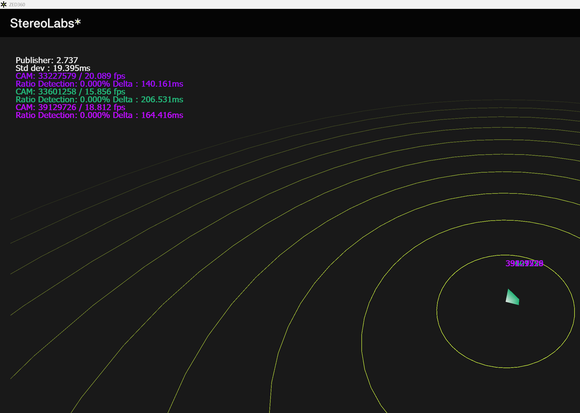

and this is what i see on ZED360

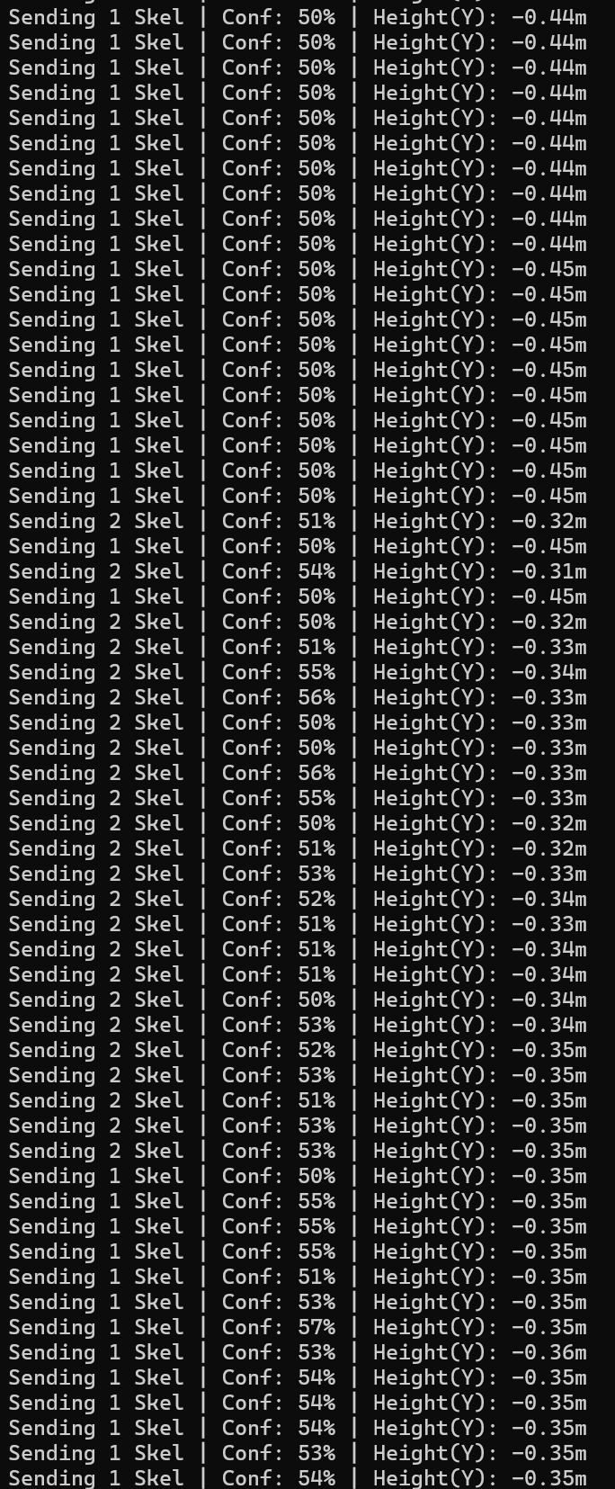

i do get some information, but no matter what the Ratio Detection remains on 0.000% and no skeleton appears.
the height of the skeleton is negative. might be the problem, but i cant manage to fix that.

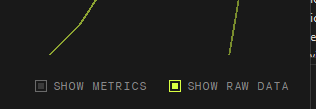

Did you enable the “show raw data” option on the bottom right corner?
With this option enabled, do you see any skeleton ?
I have.
Just a few minutes ago, i successfully fixed the skeleton issue. The problem was that the internal clock (date +%s) was 2 hours behind my main computer. Even though in the timezone in the settings was set the same.
After moving the clock 2 hours, i now see skeletons. But ratio detection is still 0.000%…
