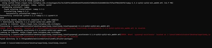

All environments are clean and newly installed. I need to install the following:
pip install requestspython "C:\Program Files (x86)\ZED SDK\get_python_api.py"pip install pymongopip install opencv-pythonpip3 install paho-mqttpip3 install torch torchvision torchaudio --index-url https://download.pytorch.org/whl/cu126pip install ultralytics   pip install tensorrt
All Python versions have been tried but none work.

I’m using Python 3.11. After only installing ZED API and OpenCV, the NumPy version is incorrect.
Installing the API with Python 12 throws an error.
Thank you for the report @AnkerLeng !
I see two issues here
1. PyOpenGL and PyOpenGL_accelerate on Windows with Python 3.12
Temporary fix:
python -m pip install PyOpenGL==3.1.9 PyOpenGL_accelerate==3.1.9
We will resolve this in an upcoming patch. Please keep an eye on the release notes to see if the fix is included in the next release; if not, it will be addressed in the following one.
