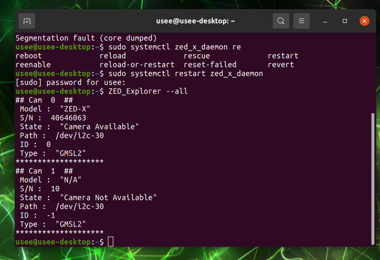

I’m trying to use a ZED X camera on a ZED GMSL2 DUO + Orin AGX 32GB. I have 3 new cameras ZED X(GMSL2). Two are displayed normally. The third camera is not detected and is not displayed. What could be the problem?
The commands did not bring results:
sudo systemctl restart zed_x_daemon
sudo service nvargus.daemon restart
ZED_Diagnostic:

Hi @nikshaman
You cannot use 3 cameras simultaneously with the ZED Link Duo capture card. Only a maximum of 2 is allowed.
We will release a new version of the ZED X driver (v.1.3) that will allow you to connect up to 4 cameras to a ZED Link Duo.
The release is expected before the end of the month if no unpredictable behaviors happen.
Sorry. I have purchased 3 cameras. There are 2 serviceable cameras working with the Zed Duo. One of the three cameras is not identified by the system as Zed X. A faulty camera is not detected in the system when connected to the Zed Duo, as well as when connecting 2 cameras.
I wasn’t going to connect 3 cameras at the same time.
The information that I have two working cameras and one non-working camera is provided to confirm that the Zed Duo is working properly with two cameras and all connections are working properly.
When you unplug one camera and you plug another one, do you reboot the Jetson or call the command sudo service zed_x_daemon restart?
GMSL2 is not plug-and-plug, each modification of the hardware configuration requires a reload of the ZED X Driver for reconfiguring the system. The command above forces this procedure.
The sudo service zed_x_daemon restart command does not help.
We tried the sudo service zed_x_daemon restart command separately and Jetson and zed_x_daemon rebooted at the same time.
It doesn’t help. The device is not identified as a ZED X.
Please send all the sudo ZED_diagnostic --dmesg reports to support@stereolabs.com.
Run them for each single camera connected to the Jetson device, please reboot after each hardware setup modification.
