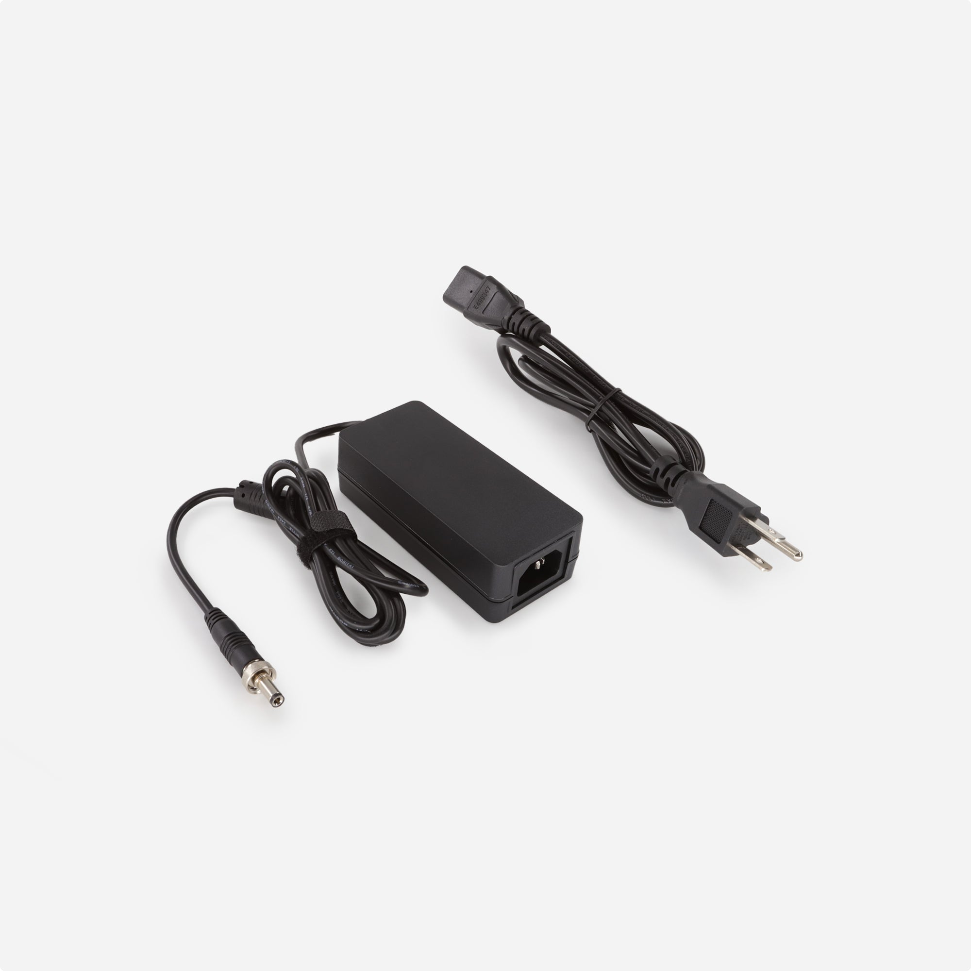

How about this power supply in your shopping mall? Does it work for it??
Yes, it’s a compatible option

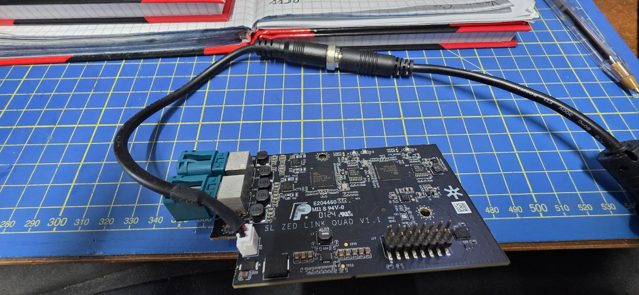

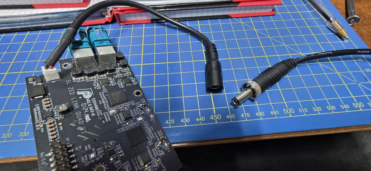

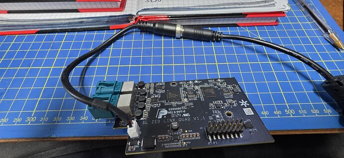

Even thought i have one more thing which is not clear for now. Based on our trial, when we use DC Screwable connector: Outer diameter 6.0mm, inner diameter 3.7mm, it is working now. But when i check your power supply for zed box orin-nx, it has DC Screwable connector: 5.52.510mm. As you can see the size is slightly different here. So suddenly i hope to cross-check with you whether we can you your power supply (DC Screwable connector: 5.52.5*10mm) for zed box orin nx or not. Thought?
Best regards,
Ryan.
As you can see from these pictures, it perfectly fits:
