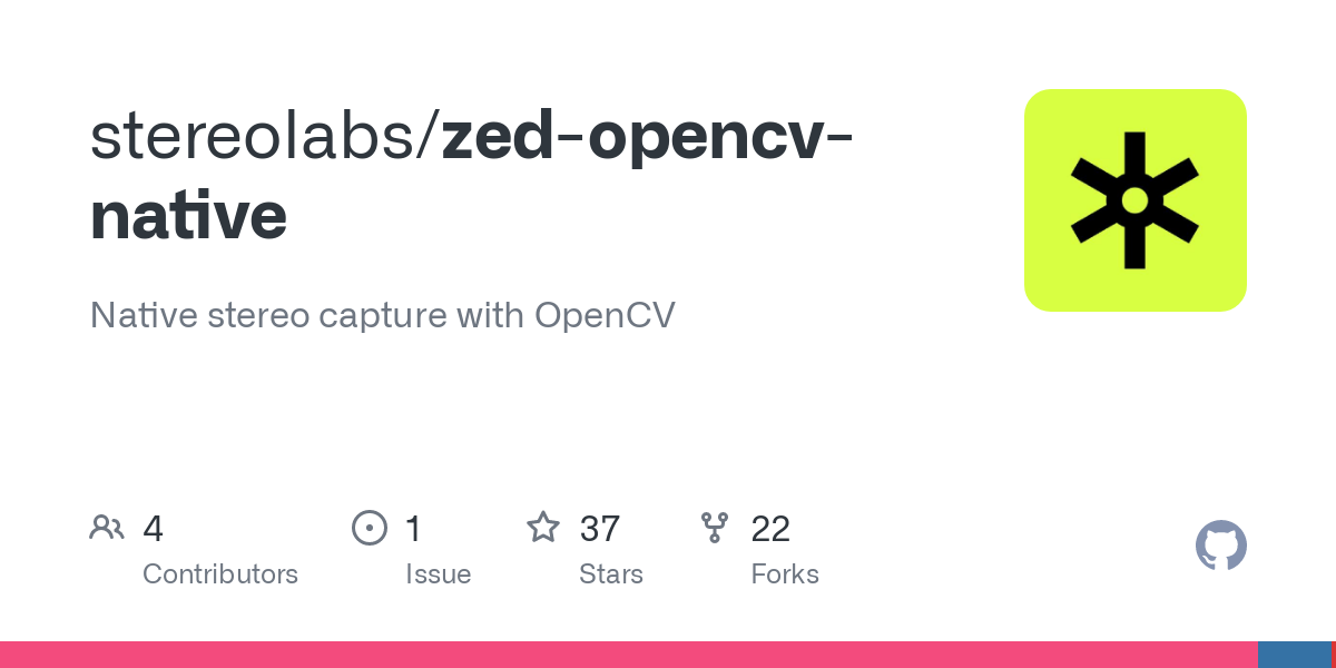

Hi @linh.nguyen
the ZED SDK does not provide this feature, but you can retrieve the native raw side-by-side unrectified stream by using UVC, for example with OpenCV:
Thanks for your confirm.
The UVC doesn’t work with ZED X which I’m using.
ZED X is not a USB3 camera, so you cannot use UVC with it.
You can use a workaround… the zedxone-capture repository also works with ZED X, seeing each camera as a separate camera.
