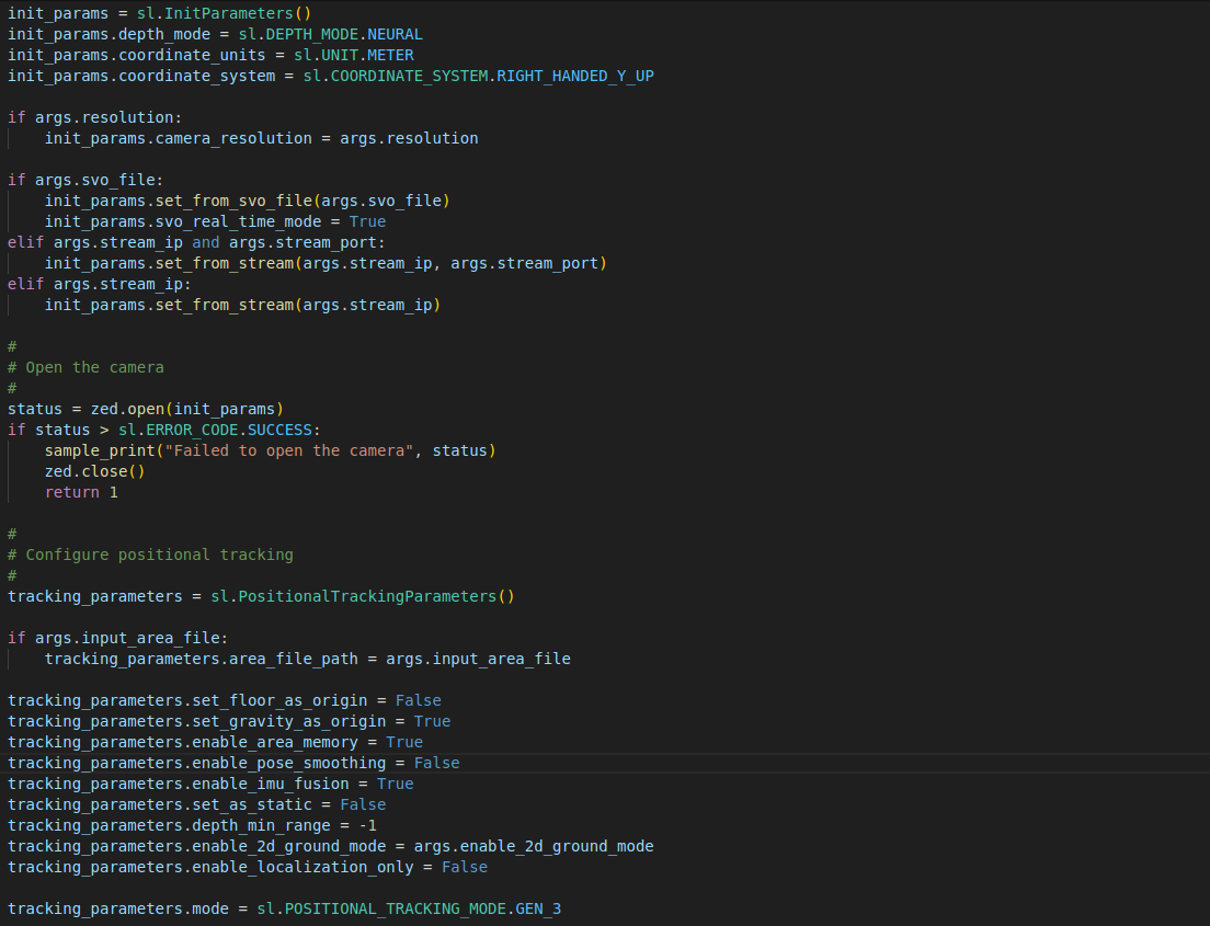

My ZED SDK version : 5.2 running on jetson orin NX jetpack 6.2
Here is my setting for Positional Tracking
Hi @DatPhamPhenikaa
This is expected if loop closure (enable_area_memory) is enabled.
The GEN_3 is fully repeatable when enable_area_memory is set to false.

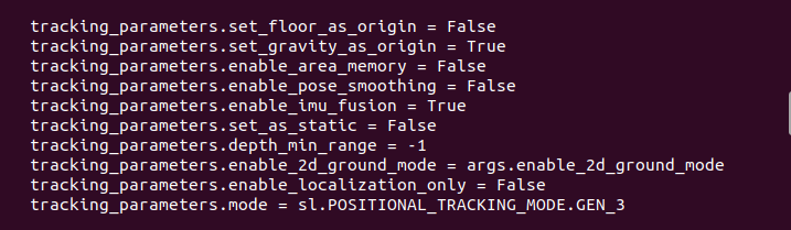

I also ran it with the enable_area_memory = False configuration, but the Pose results from the Position Tracking module remain inconsistent.

  • I also set svo_real_time_mode to false, enable_area_memory to false. But the results still inconsistent.
  • I also tested on longer trajectory but the result inconsistent again.

Here is my code
