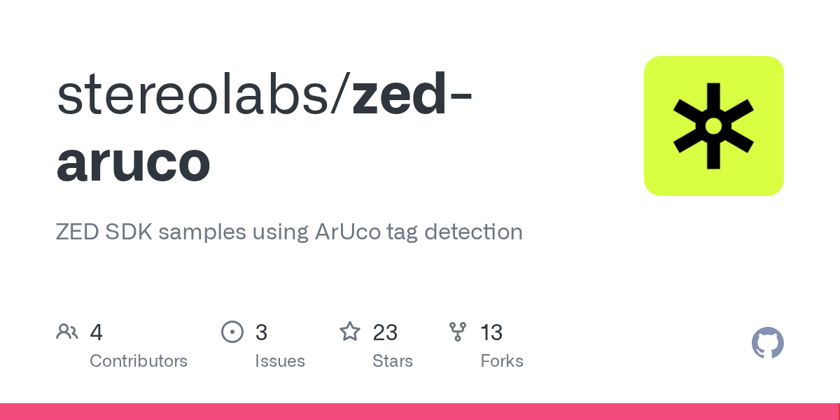

Hi @phenixyu
This GitHub repository can help you:
Hi Myzhar, Thanks for your reply, i have checked that sample which helps a lot. BTW we found we have a sample named global localization, which apply zed and GNSS/RTK, we can only use GNSS in our case, even RTK is more accurate. Can you explain if combining zed camera and GNSS could improve localization accuracy? and what accuracy can be achieved?
