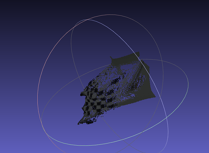

I have tried your setting but it doesn’t get better result. Here is the point cloud image by
using meshlab at 8 meters away.
I mesure the data for width of chessboard and the result is (mean, std) = (10.845 cm, 3.12556cm). But the correct width of chessboard is 8 cm.

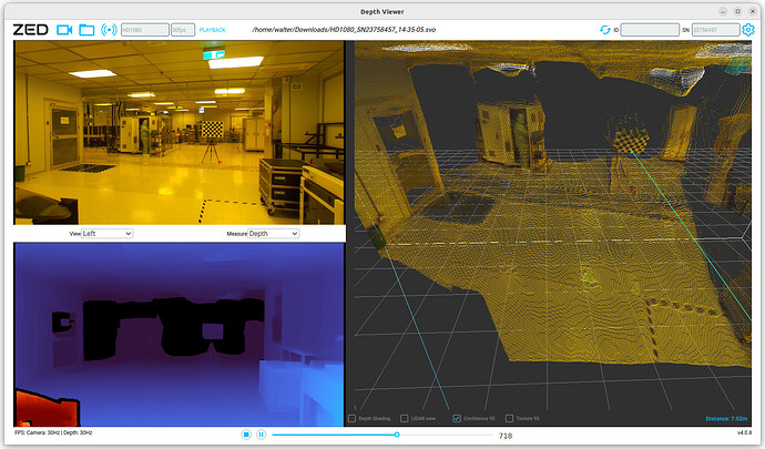

Hi @Myzhar ! Sorry too late for your response, because my expernment envienment need to be changed recently. But it still has the same problem. So I also record the SVO. Following is the chessboard expernment condition.
  1. 8cm / grid, and total pattern is 80cm x 60 cm.
  2. distance : 7m away
    Thanks for your help.
  3. URL : problem - Google Drive
The point cloud of the chessboard seems very good to me
The distance of each point is in the expected precision range which is ~2%/3% at 7 m
A curiosity: why is the light so yellow? Did you disable the auto white balance?

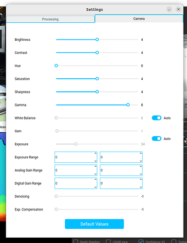

No, I didn’t disable the auto white balance. It is the ambient light and there is no way to avoid it. How do you set up the configurations.
Click on the gear on the top right to open the camera settings:
In Python, you can control all the settings by code.
On GitHub, we provide a useful example: https://github.com/stereolabs/zed-sdk/tree/master/camera%20control.
