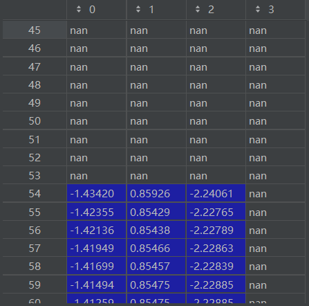

Cloud is the form of ndarray data, and it is (720,1080,4) shape, but I found that there are some problems with this data, for example, some values are nan values, and some color values overflow, like this:

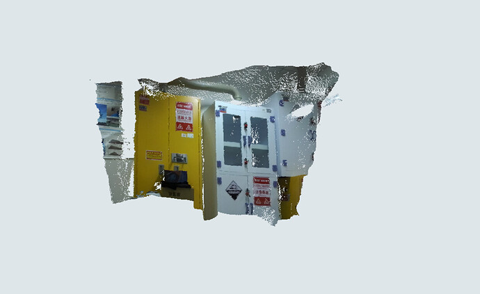

Also when I run depth_sensing, it seems normal from the OpenGL window.

what you see is expected.
nan values correspond to pixels with no depth information (occlusions, flares, reflections, low confidence values, etc).
The fourth field is the color value in 32-bit format.
You must “read” it in the correct way, thus you must convert the float32 value to an array of four 8-bit values, the first is Blue, the second is Red, the third is Green, and the last is Alpha (transparency level).
