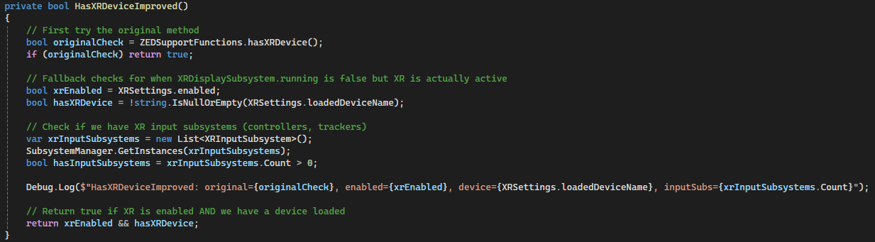

If anyone has the same problem. There’s a function in the ZED manager file called ZEDSupportFunctions.hasXRDevice(). We switched that with one we made ourselves called HasXRDeviceImproved().
I will upload an image of the code and paste the code itself aswell:
private bool HasXRDeviceImproved()
// First try the original method
bool originalCheck = ZEDSupportFunctions.hasXRDevice();
if (originalCheck) return true;
// Fallback checks for when XRDisplaySubsystem.running is false but XR is actually active
bool xrEnabled = XRSettings.enabled;
bool hasXRDevice = !string.IsNullOrEmpty(XRSettings.loadedDeviceName);
// Check if we have XR input subsystems (controllers, trackers)
var xrInputSubsystems = new List<XRInputSubsystem>();
SubsystemManager.GetInstances(xrInputSubsystems);
bool hasInputSubsystems = xrInputSubsystems.Count > 0;
Debug.Log($"HasXRDeviceImproved: original={originalCheck}, enabled={xrEnabled}, device={XRSettings.loadedDeviceName}, inputSubs={xrInputSubsystems.Count}");
// Return true if XR is enabled AND we have a device loaded
return xrEnabled && hasXRDevice;
