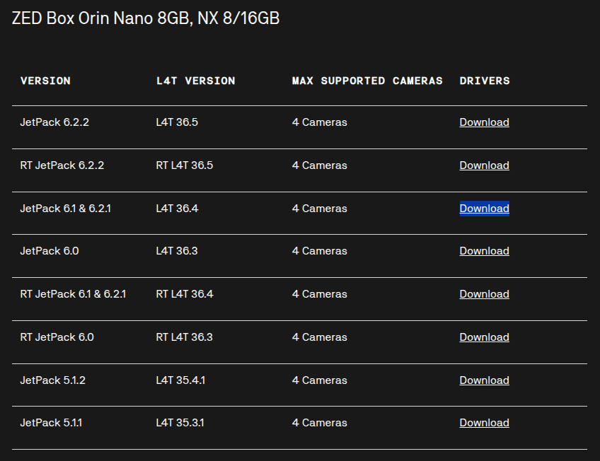

You installed the wrong driver. This is the driver for the ZED Link duo installed on a Jetson devkit, you cannot use it with a ZED Box.
You must install this driver:
Please uninstall the wrong driver and reboot before installing the correct one.
Good morning,
Thanks, it works now.
