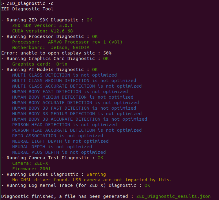

I have tried deleting all the files from /usr/local/zed/resources and optimizing multiple times. Zed diagnostic doesn’t indicate any obvious issues
ZED_Diagnostic_Results.json (16.2 KB)
Update: After deleting the models again, rebooting, and rebuilding my docker image again the optimization process completed. I never saw the shared GPU usage go above 20%
