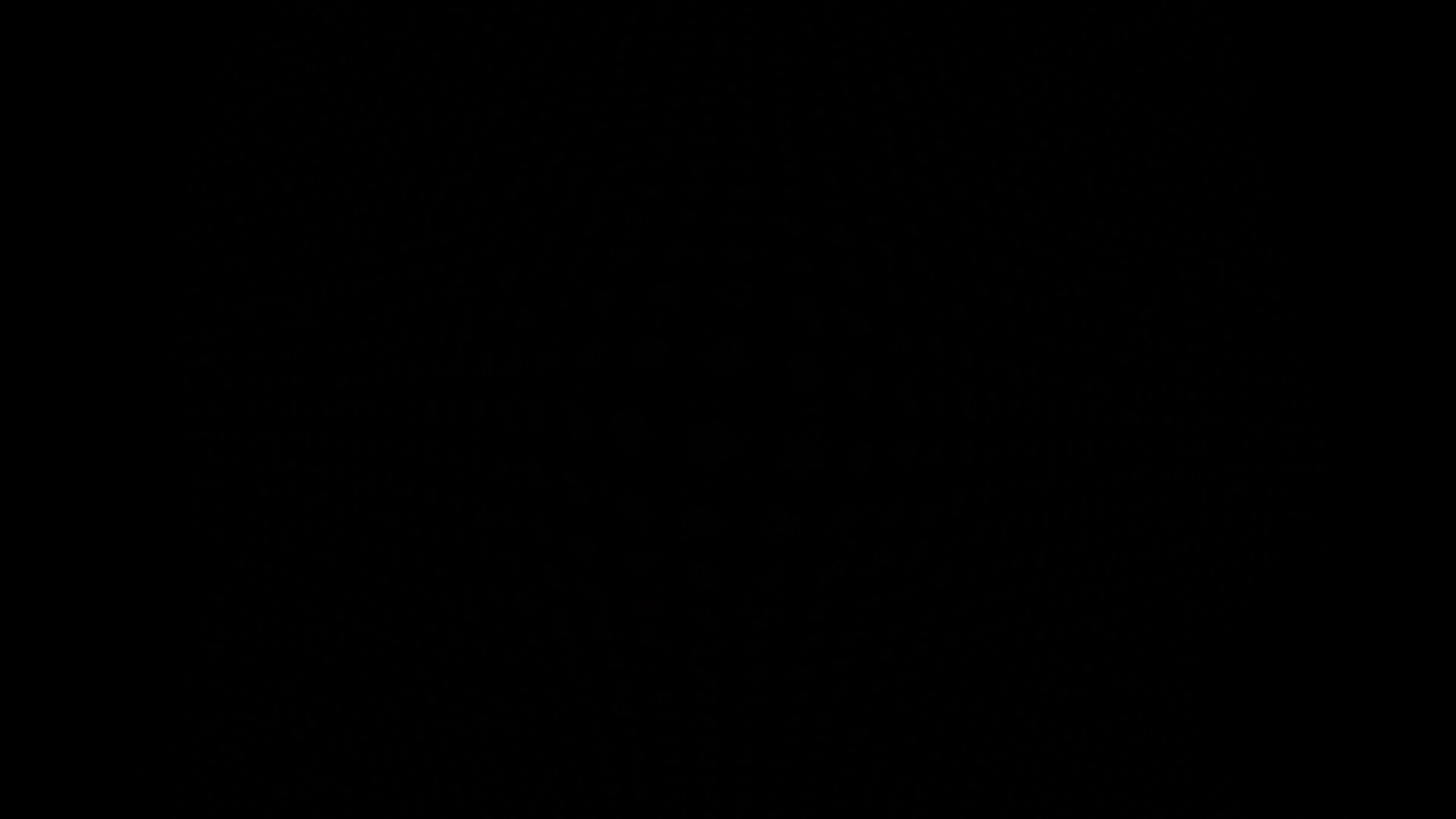

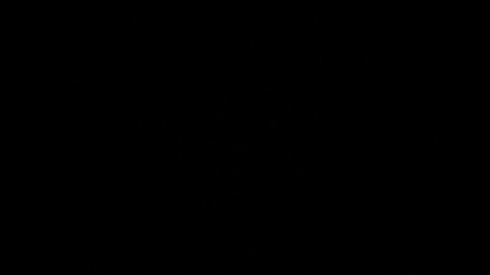

The image buffers come back zero-filled
The left image, written by the SDK itself via Mat::write() rather than by any code of
ours, is uniform RGB(0,134,0) across all 2,073,600 pixels. Not one pixel differs.
That value is the giveaway: an all-zero YUV frame (Y=U=V=0) converted through BT.601 gives
R=0, G=135, B=0. So what we are being handed is an uninitialised image buffer, while
grab() continues to return SUCCESS.
retrieve_measure(MEASURE::DEPTH) at the same moment is 99.94% NaN. The 0.06% that is
finite all sits between 0.39 m and 0.88 m, which is noise rather than scene.
Depth is therefore not falling back to a cheaper mode. There is no image behind it. And the
frame rate rises (14.9 to 25) for the same reason: processing nothing is fast.

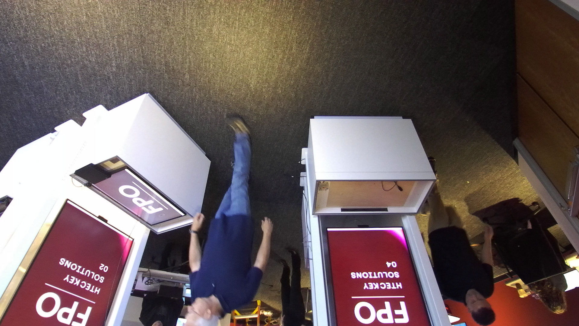

What we found: we stopped our service and grabbed both views with camera_image_flip OFF.
  • The camera’s own LEFT sensor (VIEW::LEFT, unflipped) was dark. Mean 0.72/255, max 6, only 33 distinct values, even across the whole frame. That looks like dark-frame sensor noise, NOT zero-filled buffers.
  • The right sensor was completely normal (mean 97/255).
  • Someone on site confirmed the glass was clean and nothing was covering the lens. We also removed a cable near the camera, and it made no difference.
What fixed it:
  1. A full process restart (close + open) at 09:47: no change. Depth was collapsed again 3 s into the new process.
  2. sl::Camera::reboot(39396088, true) at 09:58: fixed. Both USB interfaces re-enumerated, both sensors came back normal (mean 83 and 84/255), and valid depth went back to 98.4% with the health flags clear. The floor lock survived.
