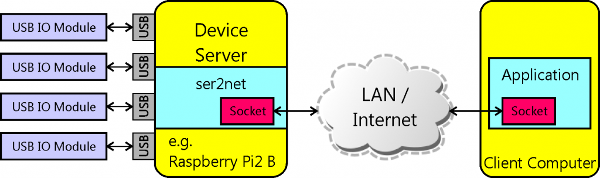

If you cannot get the SL code to work, it may be worth trying to use socat to route usb connections over IP and back to USB
