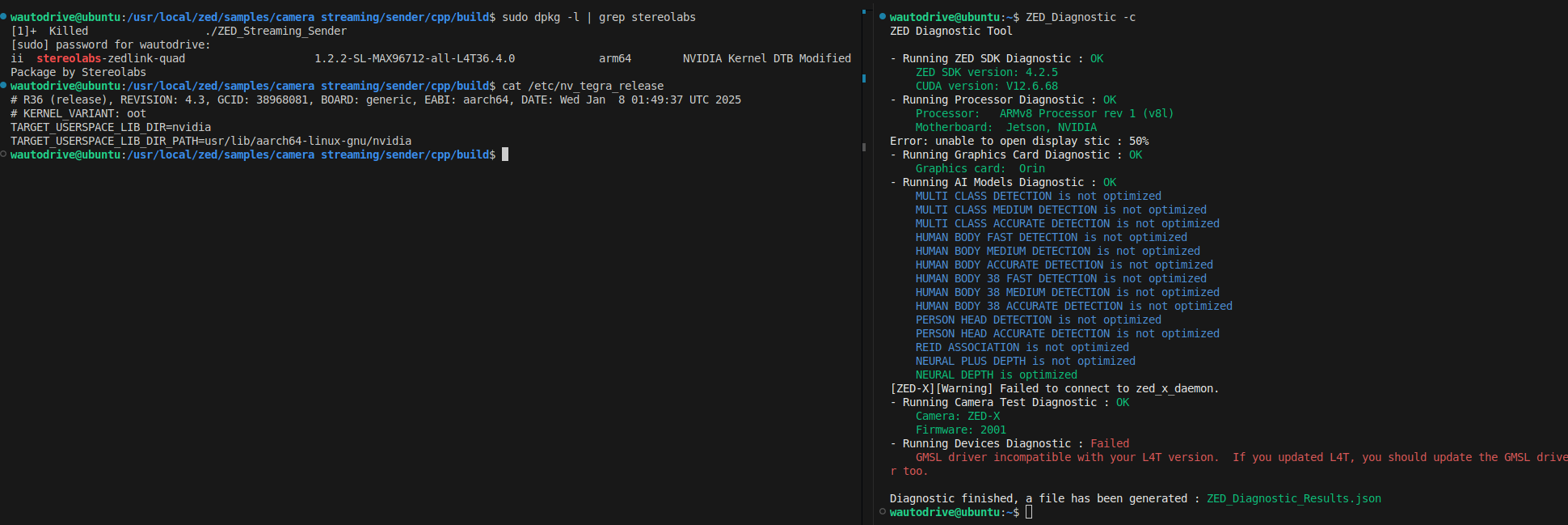

wautodrive@ubuntu:~$ ZED_Media_Server --clear-memory

Note: --clear memory doesn’t delete /dev/shm/sl_local_* files, I have to delete them manually and can only use the GUI to launch the X ONE as a Stereo Pair. I also cannot use kill -9 to kill the ZED_Media_Server --cli process, only restarting helps.

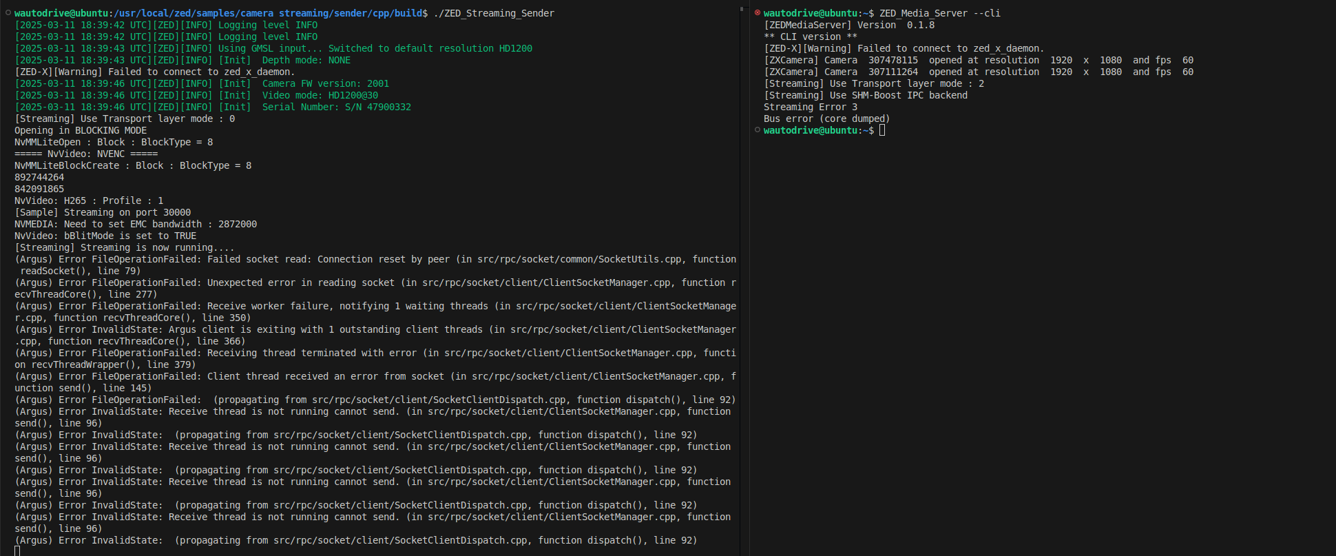

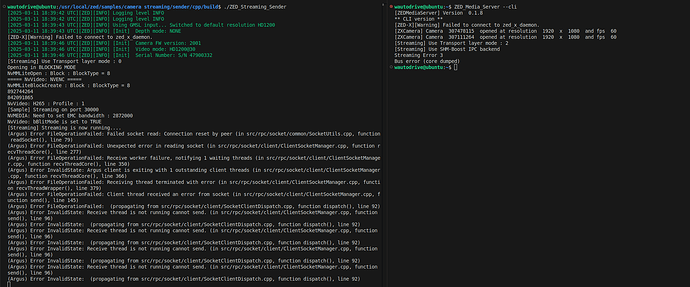

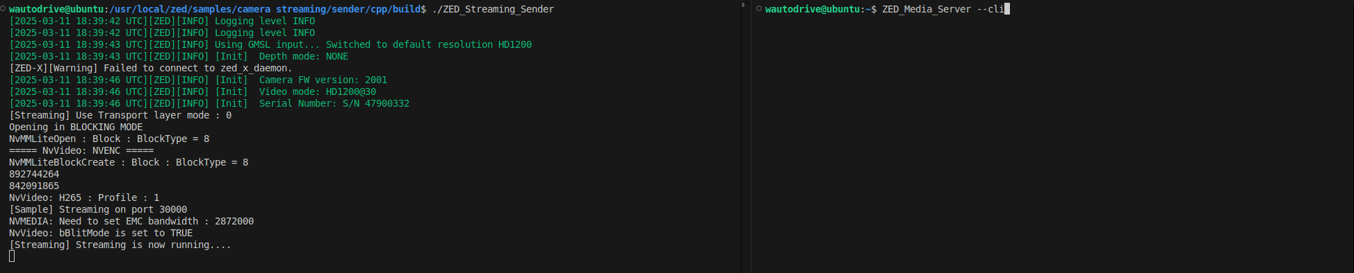

Coming to the ZED X, I can stream using the camera streaming script in samples as shown below without any issues:
But as soon as I try to use the ZED_Media_Server it messes up my ZED_X stream while it itself gives me a seg fault.
I’m sure that One ZED X and 2 ZED X ONEs is a supported configuration on Quad Capture Card connected to an AGX Orin and hence cannot understand the issue.
Ideally, I’d like to have access to a sample or API that can help me create a single streaming script (essentially to modify the sample script available for ZED X) to create a virtual X ONE pair too and stream that along with ZED X. I’d be happy with using ZED_Media_Server -- cli too if we can get that to work.
