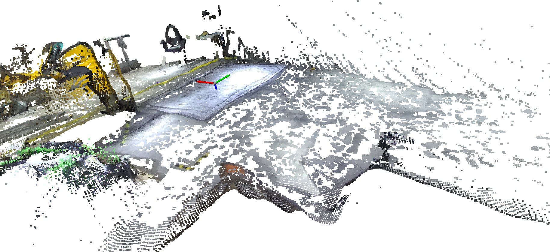

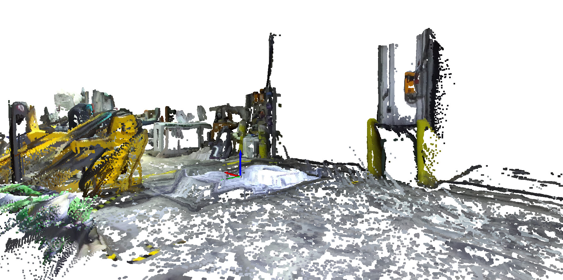

I’m testing a multi-camera application for a client and I have noticed that pointcloud quality in the Fusion module is significantly better, especially on ground surfaces than individual camera pointcloud retrieval. For reference:
Merging individual pointclouds with sl.Camera.retrieve_measure():
Fusing pointclouds with sl.Fusion.retrieve_measure() :
The only reason I am making this rather obvious issue is to understand whether I can somehow apply the processing improvements of the Fusion module to per-camera retrieval because I’m having issues with the Fusion API in python and more specifically synchronization, even though I am connected with a local USB3.0 connection. It seems that synchronization parameters are read-only in python, but this is an issue for another topic.

Hardware: 2 x zed2i on a jetson orin nano
API: pyzed
SDK Version: 5.1.0
Basically the cameras are statically mounted running on the following settings:
InitParameters (Both):
Resolution: HD2K@15
Depth mode: NEURAL_PLUS
Depth stabilization: 30
RuntimeParameters (Mono):
confidence_threshold = 50
texture_confidence_threshold = 80
remove_saturated_areas = True
RuntimeParameters (Fusion):
remove_saturated_areas = False
PositionalTrackingParameters (Mono):
set_gravity_as_origin = False
set_as_static = True
PositionalTrackingParameters (Fusion):
Undefined
In the dual mono setup the pipeline is:
  1. cameras are initialized as sl.Camera() objects
  2. opened with init params
  3. positional tracking enabled
  4. frame grabbed with runtime params
  5. pointcloud retrieved with retrieve_measure(pcl, sl.MEASURE.XYZRGBA, sl.MEM.CPU)
  6. Merged with Open3D taking into account extrinsics calibration (no denoising in the pictures)
In the fusion pipeline:
  3. start publishing as senders
  4. Fusion initialized with params
  5. frame grabbed with runtime params
  6. pointcloud retrieved with retrieve_measure(pcl, sl.MEASURE.XYZRGBA, sl.MEM.CPU)
  7. fusion.process()
  8. fused pointcloud retrieved with retrieve_measure(pcd_mat, cid, sl.MEASURE.XYZRGBA, reference_frame=self.fusion_ref_frame)
Other params that I have not stated should be negligible. Please let me know if there is anything else I could define to give a better picture.
As a general sense however, doesn’t the Fusion module perform extra denoising steps on its own? That’s what I have understood from the docs.
